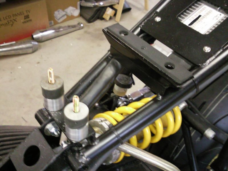

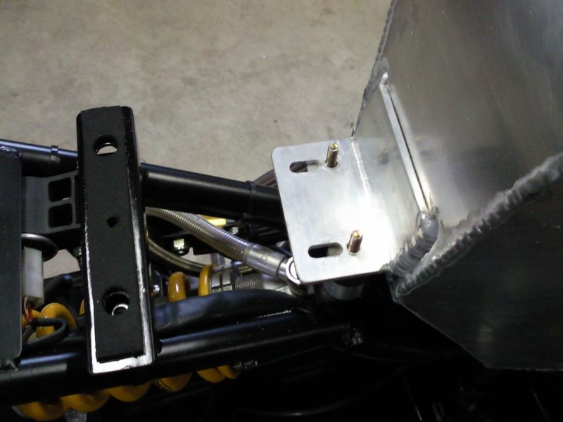

Admin Jaap Posted May 13, 2010 Author Posted May 13, 2010 To properly align bodywork and tank we had to raise the rear tank and seat mount.

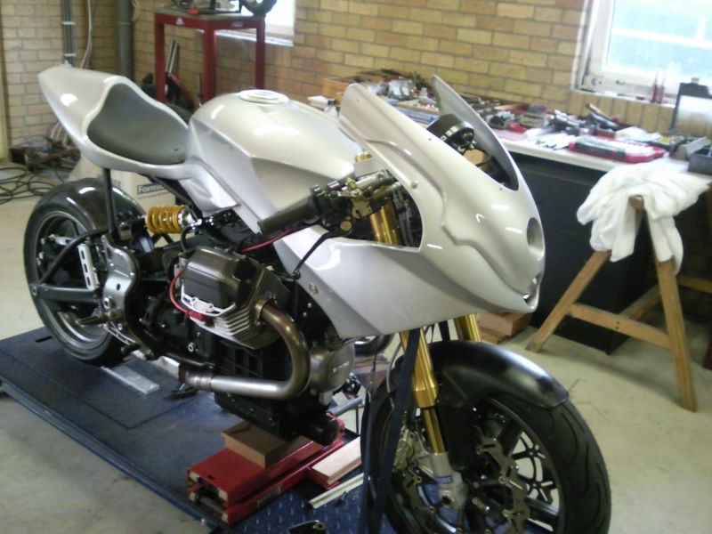

Admin Jaap Posted June 4, 2010 Author Posted June 4, 2010 Just an update: Bike is almost ready! As far as I could see yesterday, the only things that have to be done are new brake lines, exhaust (thinking about the Stucchi Breva 2-in-1 X-over and Mistral exhaust) and the license plate stuff. At the same I'll have the paintwork done and then she's ready for the road/track! Can't wait!

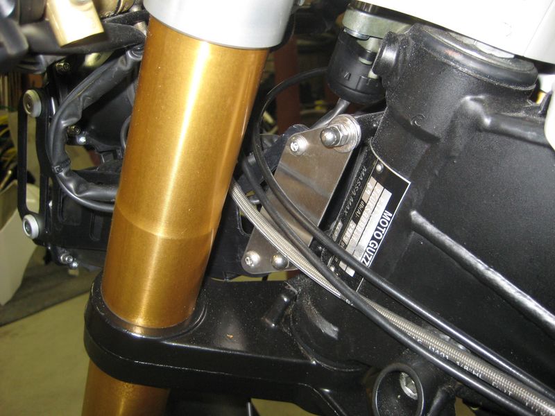

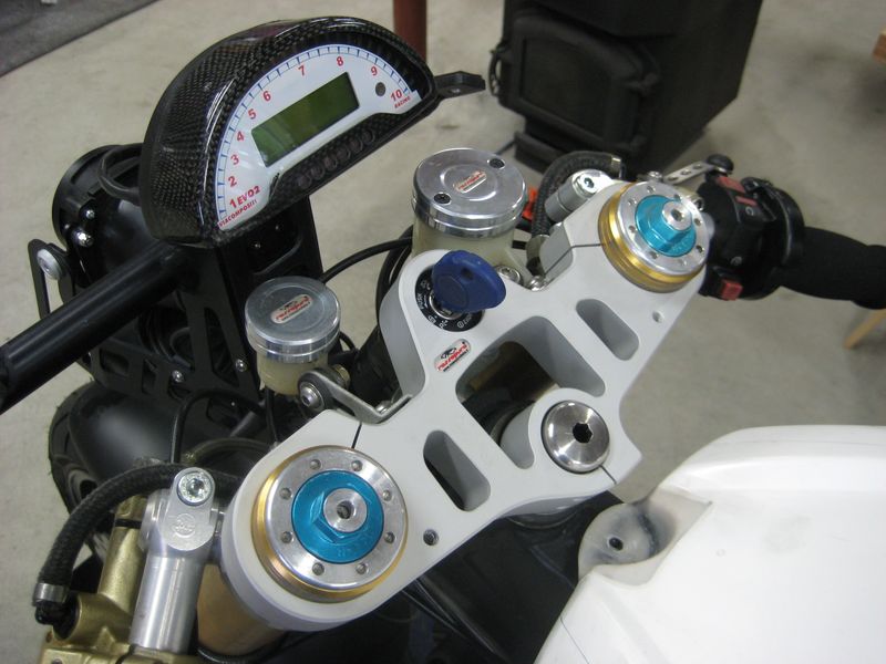

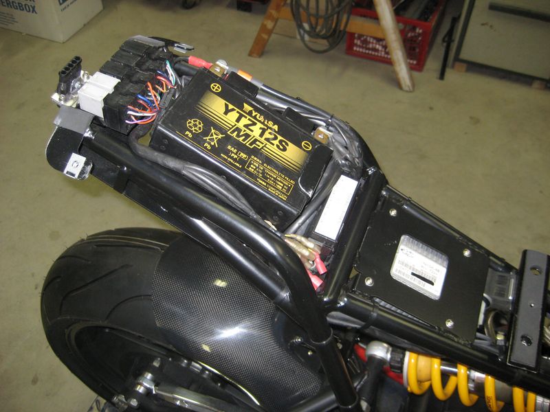

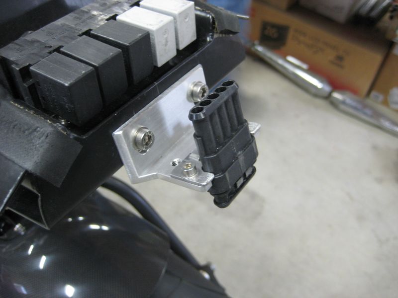

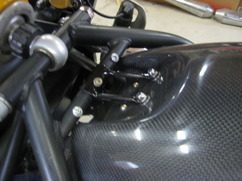

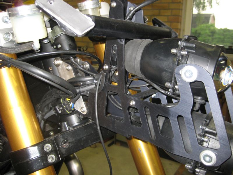

Admin Jaap Posted June 8, 2010 Author Posted June 8, 2010 What a great use of space! All the electrical stuff in the rear: The hugger mount was a bit flimsy, so my brother made something nice: Rear lights and indicators in one connector so that I can take license plate and the other stuff off with only two bolts: The Rossopuro triple-tee looks great! The brake and clutch oil reservoirs are mounted on the triple-tee with the original brackets slightly altered. Placed on the usual spot thy wouldn't clear the fairing. Front fairing frame had to be altered slightly and head light mount had to be repositioned with 2 brackets to have the fairing line up nicely with the tank

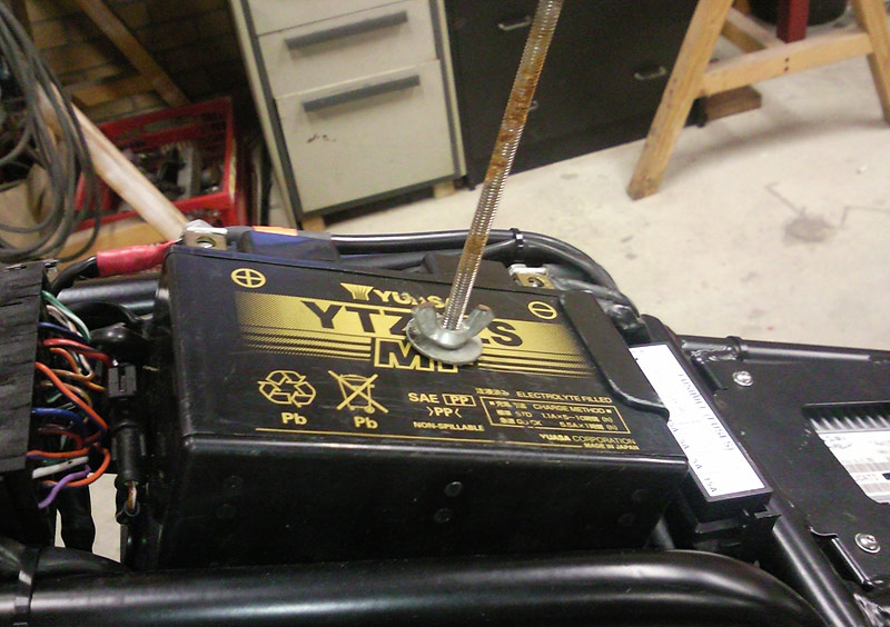

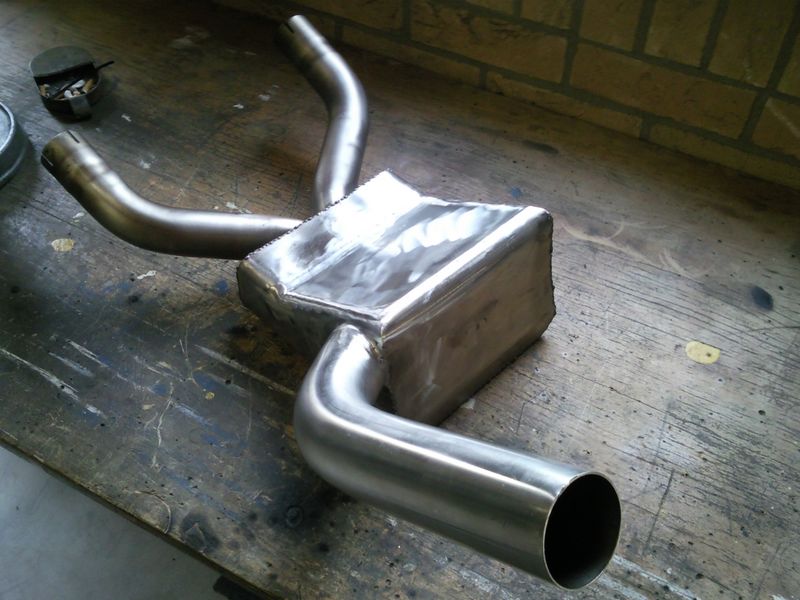

Admin Jaap Posted June 19, 2010 Author Posted June 19, 2010 Quick follow up: Yesterday we installed the new front brake lines. Today we are starting with the buiding of the exhaust. It's going to be a two stage design with a box type collector under the gearbox. This contains perforated sheet metal for creating back pressure. Out of this box comes a 54 mm to +/- 120 mm megaphone type muffler with a perforated pipe and stainless steel wool interior. Of course the muffler ends with a reverse cone made from billet on a lathe. My brother consulted a gas flow technician and he said that this could work very well. We use 0,7 mm. ss sheet material for the box and the muffler. It seems that a lot of exhaust dB's originate from resonating sheet material. Adding a db-killer is also going to be possible. And coming friday I can pick up the paintwork! :pic: The rest of the bike is ready and runs. (that's important too) Just a quick question: We came up with this solution for fastening tha battery. Because it's a gel battery, this should work. What do you think? 1

gstallons Posted June 19, 2010 Posted June 19, 2010 Quick follow up: Yesterday we installed the new front brake lines. Today we are starting with the buiding of the exhaust. It's going to be a two stage design with a box type collector under the gearbox. This contains perforated sheet metal for creating back pressure. Out of this box comes a 54 mm to +/- 120 mm megaphone type muffler with a perforated pipe and stainless steel wool interior. Of course the muffler ends with a reverse cone made from billet on a lathe. My brother consulted a gas flow technician and he said that this could work very well. We use 0,7 mm. ss sheet material for the box and the muffler. It seems that a lot of exhaust dB's originate from resonating sheet material. Adding a db-killer is also going to be possible. And coming friday I can pick up the paintwork! The rest of the bike is ready and runs. (that's important too) Just a quick question: We came up with this solution for fastening tha battery. Because it's a gel battery, this should work. What do you think? Make sure you use stainless steel for corrosion. p.s. let someone else do the drilling, mounting and first start-up.
richard100t Posted June 19, 2010 Posted June 19, 2010 I think that is a brilliant idea for the battery mount! That is a perfect post to mount all your expensive electrical accesories to. Lets see now, handwarmers, ipod, gps, laptimer... you may need a longer stud!
Admin Jaap Posted June 26, 2010 Author Posted June 26, 2010 The G&B was started for the first time this morning! The custom box exhaust dampens very nicely. Paint is not ready yet... Will be done after the Guzzi track day on July 5th. The stainless steel box exhaust: inlet tubes from a Stucchi x-over. Box design and welding by my brother. Really big outlet pipe (60 mm.)
