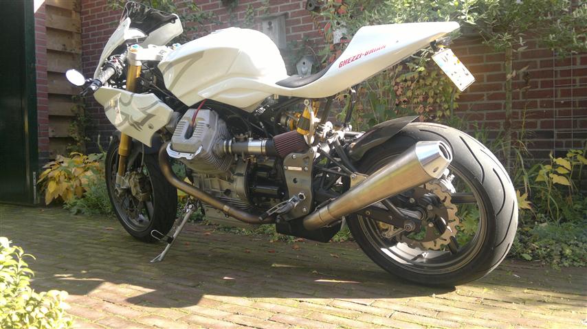

Admin Jaap Posted October 24, 2012 Author Posted October 24, 2012 The most recent picture, with the Centauro engine
Dan M Posted October 24, 2012 Posted October 24, 2012 On 10/24/2012 at 9:32 PM, Admin Jaap said: The most recent picture, with the Centauro engine Nice! Much difference in performance?
Admin Jaap Posted October 26, 2012 Author Posted October 26, 2012 Yes, not as grunty as the V11 engine, but over 5000 rpm it's bloody fast!
helicopterjim R.I.P. Posted October 26, 2012 Posted October 26, 2012 On 10/26/2012 at 8:18 AM, Admin Jaap said: Yes, not as grunty as the V11 engine, but over 5000 rpm it's bloody fast! Oh my - what Jaap says is sooooooo true. My Centauro is actually a litle dangerous on wet roads - it hits like a two-stroke at 5000 and revs to 9000. Oh my ......
juicersr Posted October 28, 2013 Posted October 28, 2013 Jap, any regrets on installing the Centauro motor? Was it a total pain? I have a line on a motor and am considering. Thanks
Admin Jaap Posted October 29, 2013 Author Posted October 29, 2013 Not at all, although the engine has a different kind of grunt than the V11. Sent from a clever thingy with a microprocessor and an interweb connection 1
helicopterjim R.I.P. Posted October 31, 2013 Posted October 31, 2013 On 10/29/2013 at 9:59 PM, Admin Jaap said: ........, although the engine has a different kind of grunt than the V11. That is an understatement .....!!
