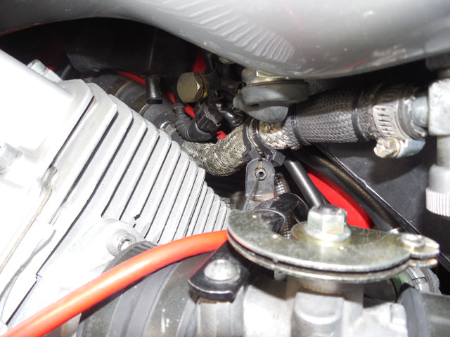

docc Posted March 5, 2014 Posted March 5, 2014 I shielded mine with a zinc plated/ braided copper tubing that I believe I sourced at the auto parts. It's probably 5/8" diameter and slides over the 1/2 fuel line. The same material (usually smaller) is used to make up grounding straps. Also, I shortened my line to get it away from the cylinder finning and used zip-ties and braided plastic (likely polypropylene) shielding to seal the ends of the braided metal cover. In the photo, you can also see a couple zip-tie heads positioned to hold the line off the throttle cable guide and keep it from slipping onto the cable itself.
stefano Posted March 5, 2014 Posted March 5, 2014 thanks docc, think i'll try couple speed shops for this, may end up using what i bought, it's not on the hi pressure side of the pump, & it's pretty tough looking stuff,but no shielding. the big breather hose was kinda fun to replace, but the throttle body sleeves were pretty easy once they were lubed up. with the tank & aircleaner box off, guess i might as well put in the shift pawl spring spring that i've got in the spare parts box it's pretty easy to get to now, & it's probably due. so it goes...thanks
