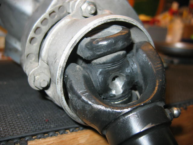

docc Posted June 22, 2010 Author Posted June 22, 2010 Ok, then, good to go! (sort of ) The seal's out and in. Thanks for the pointers. I decided to pull the drive and do the job on the bench. Easier, I think, than lying on the floor. While out, I cleaned up the U-joints and figured I'd go after them with the grease gun again. Indeed, the grease fittings can go missing: Now to try and find a replacement. I suppose it is angled, what, 45 degrees? And this is pipe thread or something otherwise special?
gstallons Posted June 22, 2010 Posted June 22, 2010 Look at the other fitting on the opposite joint. Probably a 45 degree fitting & metric thread. Take the other fitting with you to match it up. Go to an established auto parts store for the correct fitting.
docc Posted June 22, 2010 Author Posted June 22, 2010 Thanks for the tips! The seal changed pretty easily. I still haven't run it in to see if it holds redLine. During the cleanup I found the rear U-joint had spit off its Zerk fitting. I couldn't find one angled so fitted a straight then tried to grease it with a needle. Between that and the front, the whole thing is a fiddly greasy mess. I do think I managed to get some grease in the joints this time.
jrt Posted June 23, 2010 Posted June 23, 2010 Ok, then, good to go! (sort of ) The seal's out and in. Thanks for the pointers. I decided to pull the drive and do the job on the bench. Easier, I think, than lying on the floor. While out, I cleaned up the U-joints and figured I'd go after them with the grease gun again. Indeed, the grease fittings can go missing: Now to try and find a replacement. I suppose it is angled, what, 45 degrees? And this is pipe thread or something otherwise special? Yes, mine is angled about 45 degrees (ummm, wait a sec). Dunno what the threads are but they are bound to be metric equivalent of pipe threads I imagine. Not near my bike, so I can't look.
gstallons Posted June 23, 2010 Posted June 23, 2010 Docc, You probably need a 6mm 1.0 thread pitch w/45 deg. angle grease fitting.
docc Posted June 23, 2010 Author Posted June 23, 2010 The only M6-1.0 45 angle available to me locally is much too large for the space. I tried to "see" the one in the front, but *ha.* Even with lighting and a dental mirror on the end of a long hemostat, I could only focus on the little bugger with one eye; and even then through a less than optimal segment of my corrective lens. Even after ten years, the damn U-joints remain elusive. In fact, I think I doubled my vocabulary today . . .
gstallons Posted June 24, 2010 Posted June 24, 2010 Docc, mark the driveshaft at the sip yokes so you can install it the way it came off and remove that portion (of the driveshaft) and take it with you......... after looking at it I see it's the rear joint. Remove the two pinch bolts that hold it to the splined shaft. It should slide right off.

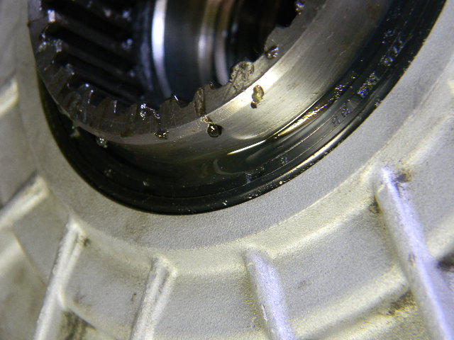

docc Posted June 5, 2012 Author Posted June 5, 2012 I just did a google search to find out what to do about my leaky rear drive . . . and found my own thread! Perhaps flattering , but otherwise not good. Two weeks out from the Spine Raid and the blasted thing still drips. Tried Lucas "Hub Oil" made for just this thing, and which seemed to help, but still drippy. I suppose I'll try to fit a new big seal and hope for the best.
HaydnR Posted June 5, 2012 Posted June 5, 2012 I take it that you have checked that the breather is not blocked and that the leak is definitely from the big seal ?

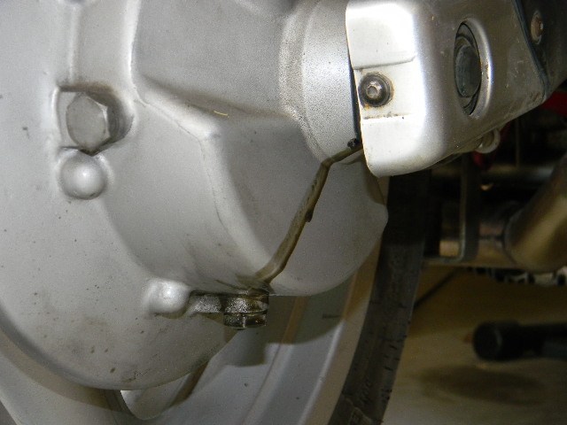

docc Posted June 5, 2012 Author Posted June 5, 2012 I take it that you have checked that the breather is not blocked and that the leak is definitely from the big seal ? Definitely have cleared the vent. Just cleaned her up with the wheel off and rode about 50 miles. One big drip hanging from the large seal and the run coming from the right side. The large left seal is easy to do, but where is the other drip coming from?
HaydnR Posted June 5, 2012 Posted June 5, 2012 Have you changed brand of oil, looks like both the inner and outer seal are leaking. Is the pinion seal leaking too for a full house?
