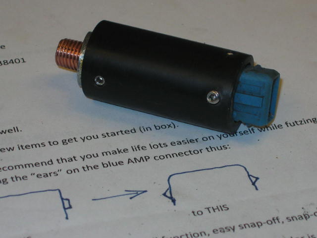

docc Posted July 11, 2010 Posted July 11, 2010 Altering the holder for the Engine Temperature Sensor has been the topic of much trial, error, and debate. After almost eight years and over 55,000 miles, I decided to swap to the brass sensor holder (GU 30163301) and packed the housing with copper paste. Not that I needed to change it, but it was all the rage at the time and my Guzzichondria got the best me. I wasn't sure it ran any better, in fact I thought it got a bit worse, but went on to chase down a series of other, mostly electrical, issues. I rode the Sport two years, around 14,000 miles, before switching back to the original plastic/composite/Bakelite holder with no packing paste. Right away, I felt she ran a bit better. Not a lot, but a bit. So, taking the path less traveled, with the help of TFMKasRH (The Former Member Known as RatchetHack), I removed my thermister from its crimped housing using a Dremel with cut-off wheel (I figured I could JB Weld it back if needed since new sensors are 105 USD), fabricated a Delrin holder using a 22mm length of copper stud and 5mm air gap with stainless steel set screws. I have only ridden it five or six times with a total of maybe 250 miles. But, here are my observations so far: 1) Low angle throttle transitions are much smoother. Rolling into a corner, I've become accustomed to some unsettling sputtering and burble which caused a little hesitation as the throttle was rolled on for the exit. This transition is notably smoother making for much smoother and reliable cornering transitions. 2) Idle and low throttle angles, especially at low (under 3000-3500) rpm are more stable. The motor has never liked to plod along under 3000 rpm (I know it's a bad idea for other reasons) always bucking and sputtering especially right at an indicated 2800 (my tach is 300 rpm high BTW). This sputter is entirely gone. 3) There is much improved high temperature sensitivity at traffic lights and parking lot maneuvers. It has been quite hot here and the first test ride was some spirited riding into town then sitting in traffic and navigating a parking lot at 96 degrees Fahrenheit (35˚C). There was nary a hiccup or sputter or stumble. With nearly 72,000 miles and ten years riding this bike, this is unprecedented. 4) My fuel economy is unchanged. TFMKasRH noted a 10% improvement which I thought would be great. Alas, so far, not so for me. Summertime I get 35.5 - 37.5 mpgUS (sure 40-41 at steady throttle with no cogging and hair shirt corner exits, but who wants to ride like that?); wintertime (under, say 60ºF) 32.5-34.5 mpgUS with the lower figures closer to my 40˚F/ 4,4˚C riding limit. I am really enjoying the smoother, more stable character. On a zero to ten scale (zero= not running, ten= running phenomenally), my Sport is usually an 8-9; 10 on a cool crisp morning at 5000+ rpm, and 6-7 in hot traffic. (Well, there was that once or twice it was a zero!) Right now, she's giving me a solid 9-10 even with the heat. With this much seat time for comparison, I'm looking forward to getting some time and miles for a more complete impression. Hey, maybe I'll end up with those other 3 or 4 mpg! EDIT: August 21, 2014 - with almost 20,000 miles on this "modification", I can say it has performed flawlessly. I was concerned the thermistor would just burn up, but no. The wiring connector did come undone once, and the holder loosened one time. My fuel economy never improved, but the harsh running in hot conditions never returned. 1

GuzziMoto Posted July 12, 2010 Posted July 12, 2010 'Moto, you're combining assertions that weren't related, & misquoting as well. His mod was specifically targeting the problems that many forum members have reported w/ excessive fuel consumption in cooler weather, while simultaneously running too lean in hot weather. His proposed mod to wire in a pot so that he could dial in his own fueling corrections was an initial foray into resolving this issue, a "brute force attack" if you will. The later replacement of the hot water sensor used by the factory in a "less-than-ideal-despite-official-factory-part bodge" by a GM air-temp sensor placed closer to the head so that it can react more quickly to cylinder head temp changes was entirely inspired and seemed to correct the empirically derived faults with the factory system. The fact that he's still getting slagged for his vociferous support of his mod that certain individuals w/ personal axes to grind tried to belittle says more about our community than it does about the validity or efficacy of the mod. Thanks to Docc, we now have another data point on the "the factory setup is a craptastic bodge & the v11lm.com community can come up w/ a better solution" graph. Ride on! I'm sorry, I didn't realize that saying "His idea to lower the temp the sensor reports to the ecu to cause the ecu to add more fuel (or at least not take away fuel) was not a bad idea." and pointing out where the debate got stupid was slagging him. I thought it was a positive comment. I apologize.

Dan M Posted July 13, 2010 Posted July 13, 2010 Woops, meant to add this: Thanks for posting your results Docc. I did quite a bit of work with RH picking & modifying GM sensors that ranged the same as the MG sensor as well as side by side testing. My bike is also much smoother in the former trouble range (3000-3500RPM small throttle opening with a hot motor) regardless of ambient temp. Tank range has increased as well. It is a shame people insisted on arguing about it at the time without trying the mod or testing anything themselves.

GuzziMoto Posted July 14, 2010 Posted July 14, 2010 What Docc did was cut the brass away that was insulating the thermistor. That did not change the value, it just removed the lag time to read the actual temp. A lag time that was as long as minutes. How many people have used PCs, Tune boys or other means to correct fueling and while at it were compensating for inaccuracies of a very, very slow sensor? I understand what Docc did. The debate is about what effect that had on the system. See, that is where the debate gets fuzzy. You say that the brass is insulating the actual sensor. In my experience, brass is a horrible insulator for heat. It actually conducts heat better then air, which is what you are "replacing" the brass with. I have yet to see anyone post any actual measured data that supports the theory that removing the brass and adding air increases the response time or the accuracy of the sensor. Or any evidence that the stock set up is "a very, very slow sensor". So then it comes down to opinion and belief, and that does not make for something worth debating. Docc (and Hatchet Wacker before him) has made a change to his ETS that alters the value the sensor is sending to the ECU and that is changing the way his Guzzi runs. I don't have an issue with that. But there is no evidence that he has "improved" the accuracy or response time of the sensor. The only evidence is that his bike now runs better, and by the description of the change in running it sounds to me like it is running richer. Based on what I know of the Guzzi ECU that means the moddified ETS is telling the ECU that the motor is cooler. This makes sense to me as what was done to the ETS (remove the brass and replace it with air) I would expect to lower the temp reading of the sensor. If you choose to draw a different conclusion from that action/result, fine. But unless you have some evidence to support your claim......
