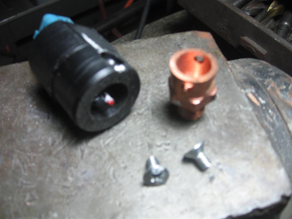

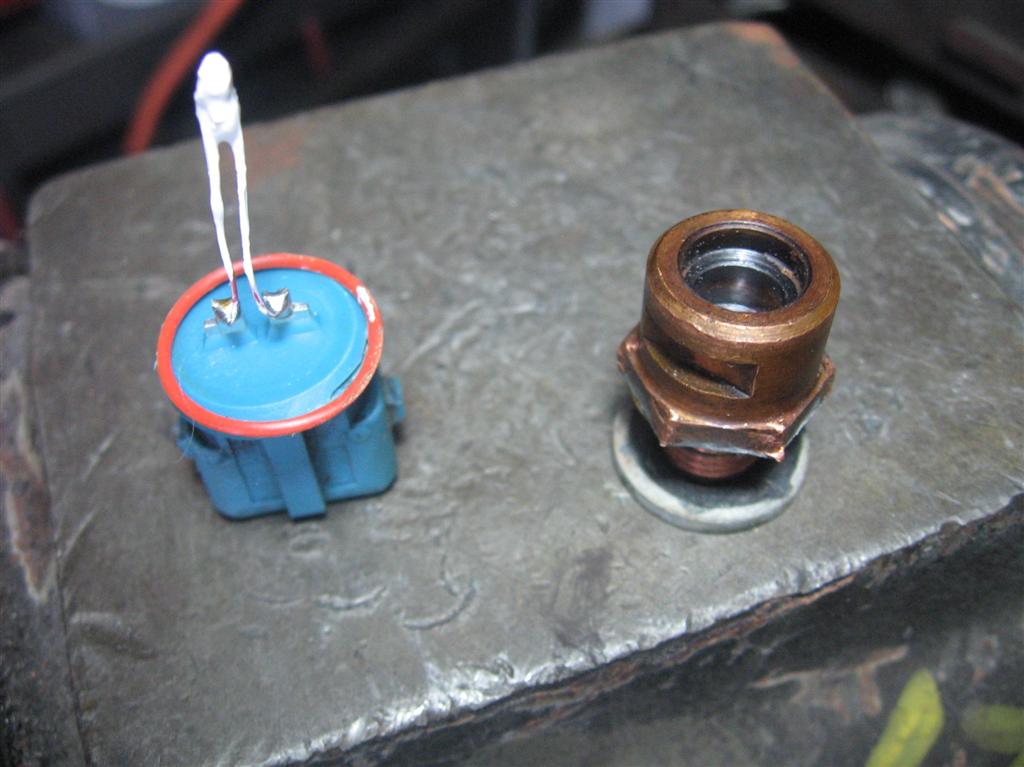

motowarren Posted August 9, 2012 Posted August 9, 2012 So after reading some of these posts and having the bike apart anyway for a shock rebuild I decided to take my temp sensor out to see what it looked like from the other end. The first thing I did was break the bake-o-lite holder. So now I'm kind of committed to doing something with it. So I took it apart ala Docc's project. Picture of parts below. But I have some questions. 1. Is the white paste of any significance IE do I need it? 2. Can I use the original bottom piece that screws into the head or do I need to modify it somehow? 3. What gap do I need between the top and bottom piece and how much tolorence do I have? I have a lathe and some acetal rod which I think is similar to Docc's delrin.
docc Posted August 9, 2012 Author Posted August 9, 2012 1) No paste required. 2) How do you propose to attach your new acetal holder to the existing base? (Less mass is the goal with this modification and a simple short length of threaded copper rod works well). 3) 5mm air gap
