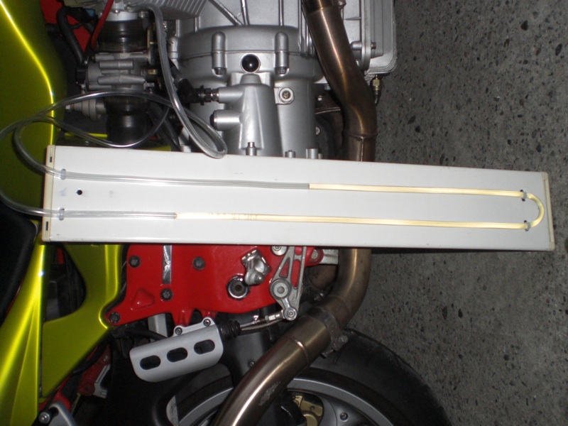

Kiwi_Roy Posted August 9, 2010 Author Posted August 9, 2010 Hi I bought my v11 in south Germany this may and rode it back to Norway. I did not notice any of the sneeze when start riding from Stuttgart( maby because of "new to me" bike riding 800km in very very heavy rain all day for two days, just wanting to get to the ferry in Kiel to warm up. Not a fun ride at all! ), but I did notice when in Norway. Could change in climate and/or perhaps different additives in fuel have anything to say? Anyway. I adjusted the valves too, from 0.10/0.15 to 0.20/0.25 and it raised idling a bit(think I want it a bit higher still) and almost removed sneezes comletely. Sneeze is not a problem now. My sparks now get a dark/black colour, not the light brown. Is that ok? I will use a Moto Guzzi garage to do the rest. What should I ask them to do next? Or, could I just raise the idling myself first, without any balancing first? If yes, how to do? Thanks. It's very easy to raise the idle, see the tread on TPS setting under the FAQ forum. If you can do your valves, you can do this. Balancing is a bit trickier but the FAQ tells you how, heres a picture of the tool I made. Use engine oil, if it accidentally gets sucked in no harm done. I made the connection to throttle body with 2 x 6 mm grease nipples, grind the back a little to remove the spring and ball. Make the final connection to the nipple with rubber hose, plastic gets soft and falls off when hot. Don't expect to get the two columns closer than about 150 mm from idle to 3000 revs. Have fun Roy
lemppari Posted August 9, 2010 Posted August 9, 2010 Hi I bought my v11 in south Germany this may and rode it back to Norway. I did not notice any of the sneeze when start riding from Stuttgart( maby because of "new to me" bike riding 800km in very very heavy rain all day for two days, just wanting to get to the ferry in Kiel to warm up. Not a fun ride at all! ), but I did notice when in Norway. Could change in climate and/or perhaps different additives in fuel have anything to say? Anyway. I adjusted the valves too, from 0.10/0.15 to 0.20/0.25 and it raised idling a bit(think I want it a bit higher still) and almost removed sneezes comletely. Sneeze is not a problem now. My sparks now get a dark/black colour, not the light brown. Is that ok? I will use a Moto Guzzi garage to do the rest. What should I ask them to do next? Or, could I just raise the idling myself first, without any balancing first? If yes, how to do? Thanks. It's very easy to raise the idle, see the tread on TPS setting under the FAQ forum. If you can do your valves, you can do this. Balancing is a bit trickier but the FAQ tells you how, heres a picture of the tool I made. Use engine oil, if it accidentally gets sucked in no harm done. I made the connection to throttle body with 2 x 6 mm grease nipples, grind the back a little to remove the spring and ball. Make the final connection to the nipple with rubber hose, plastic gets soft and falls off when hot. Don't expect to get the two columns closer than about 150 mm from idle to 3000 revs. Have fun Roy I bought and brought the Rosso Mandello from Germany, too. The first year under yours truly it used to sneeze quite offten, to the extent that it spat out either of the TB:s. After readjusting the valves to 0.2 both intake and exhaust, there's been no backfire or sneeze. Readjusting the TPS can have had some influence, too while it had been adjusted to 420 mV, all rods etc. disconnected! No wonder the plugs where coal black.
