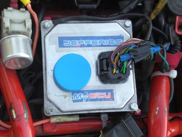

Kiwi_Roy Posted August 1, 2010 Posted August 1, 2010 Very glad to have made somebody's day, though. With my level of expertise, I'm looking forward to installing a myECU. New stories abound, for shure! That's good, I was wearing Cliff's patience pretty thin. I will be able to watch while someone else asks the stupid questions / makes stupid mistakes. Mine's not perfect yet but reached the point where I have closed the lid & no longer take the stock with me as a backup, No going back now that's for sure. Congratulations

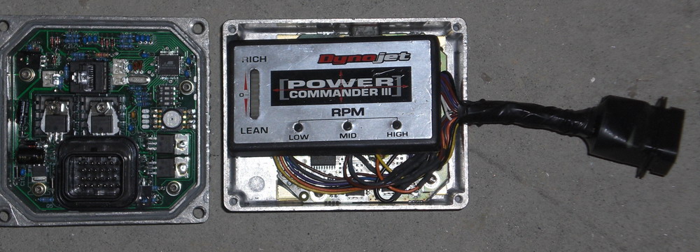

Kiwi_Roy Posted August 1, 2010 Posted August 1, 2010 Yep, and that is why I'm still wavering between the myECU and Tuneboy. With Tuneboy, I at least get started with the original map, that is, I can still ride!! Then again, if I wait a coupla months, it'll be snow and ice everywhere and I can start fiddling with the myECU safely inside in a garage, waiting for the next spring... I carried the original in the tool tray for a while, I had trouble with MyECU because I had left a resistor out, I had a Power commander so I cut the wires off it and soldered it directly to the original ECU. A couple of resistors in place of the pressure sensor i removed works great
Tom M Posted August 1, 2010 Posted August 1, 2010 Mine's not perfect yet but reached the point where I have closed the lid & no longer take the stock with me as a backup, No going back now that's for sure. Hi Roy, That ECU is mounted upside down and can be damaged by the seat base flexing and contacting the connector. I lost a stock ECU due to the PO of my bike mounting it like that. Flip it over so the connector is facing down.
Kiwi_Roy Posted August 1, 2010 Posted August 1, 2010 Mine's not perfect yet but reached the point where I have closed the lid & no longer take the stock with me as a backup, No going back now that's for sure. Hi Roy, That ECU is mounted upside down and can be damaged by the seat base flexing and contacting the connector. I lost a stock ECU due to the PO of my bike mounting it like that. Flip it over so the connector is facing down. Oh, I never knew that, it's the way it was when I bought it. Makes sense though now I think of it, the wires do get crunched a bit. Thanks for the heads-up Roy
docc Posted August 1, 2010 Posted August 1, 2010 Early Sports were mounted connector up. And their seats are bad about mashing on the battery, cutting into the battery hold strap, and pushing on the relays. I thought they flipped the ECU over in 2002 for better cooling. Come to think of it, cooling is probably better with the fins down . . .
