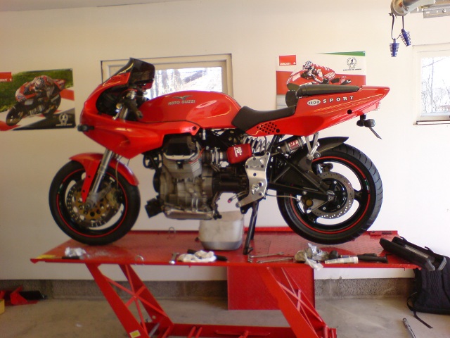

docc Posted August 5, 2010 Posted August 5, 2010 Wow, RAZ! I don't think I've ever seen a picture of your Sport. That is magnificent!
Tom M Posted August 5, 2010 Posted August 5, 2010 Wow, RAZ! I don't think I've ever seen a picture of your Sport. That is magnificent! Agreed! Nice bike Raz. How's it running after all the engine work?

raz Posted August 5, 2010 Posted August 5, 2010 Wow, RAZ! I don't think I've ever seen a picture of your Sport. That is magnificent! Agreed! Nice bike Raz. How's it running after all the engine work? Thanks, well the pic is taken without exhaust mounted so it looks a bit cooler than it normally does. More pics are linked in my signature. Anyway I think the raised compression was a good thing. I haven't experienced any problems with pinging or such, even with piss poor octane gas from the continental Europe. I get the feeling my front wheel is much more prone to get airborne but we'll never get hard facts on that. I didn't modify my ignition map. The fuel map was a little modified (enrichened) with my closed loop correction until my sensor recently went tits up. I just finished a long distance ride in open loop and all in all, the bike was just fantastic. Fantastic. It's a pity it's not really a touring bike 'cause I'm a touring guy. Maybe I'll sell it now and buy meself a good old carburetted 1975 1000 Convert. Edit: Of course, I will bore it to 1100 cc and claim it to be a V11 so I don't have to switch forum

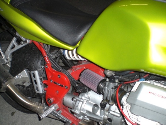

Kiwi_Roy Posted August 8, 2010 Author Posted August 8, 2010 OK I have my K&Ns on, love the look, now the spine and rear suspension are exposed, If anyone else likes this look the 10 or 20 degree might look even better, I went for the largest one in straight. Sorry about the dirty bike, just went for a quick spin in the rain. Just one thing, what to do with the crankcase breather & temperature sensor. For the moment I extended the breather down below the exhaust with a length of plastic hose and tie wrapped the sensor to the frame under tank. I welcome your suggestions for a permanent fix Thanks Roy
