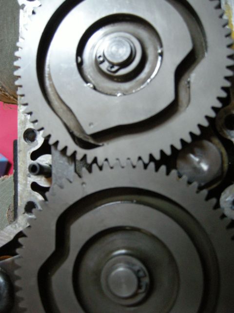

matt Posted August 1, 2010 Posted August 1, 2010 I have a 2001 V11S I have owned since new. 30,000 miles on it now. Recently when shifting up through the gears I encounter false neutrals between all gears. Sometimes if I am very deliberate with my shift I can get it to shift cleanly but not usually. I pulled the cover off the gearbox to inspect and the springs on the plate were all intact. There was a wrapped roller pin that dropped out of the case ( I asume this is where it came from). I repositioned the pin where i thought it should go and reassembled the box and tried again with no improvement in shifting. Anyone have any ideas as to what I should be looking for in the box to cause this mis-shifting? Thanks

mznyc Posted August 2, 2010 Posted August 2, 2010 Hi Matt, I have been experiencing the same symptoms and downshifts were missing also.Changed fluid,did cover spring inspection and disassembled and lubed shift linkage.Took it out for a test ride and all was well,but after bike warmed up I started missing upshifts.Thinking adjusting the eccentric adjuster under acorn nut may help,gonna try that this week.I'm also gonna check lever position as Greg suggested. I also addressed the roller pin a couple of weeks ago in a similar thread, http://www.v11lemans.com/forums/index.php?showtopic=15984 You can see the rolled pin at the left of the picture, Michael

mznyc Posted August 2, 2010 Posted August 2, 2010 Hi Matt, I didn't loctite that pin,just made sure that it was snug.May be a good idea to loctite it. Docc explains how to adjust the eccentric adjuster to me the best way here, http://www.v11lemans.com/forums/index.php?showtopic=15818&st=0&p=171149&fromsearch=1entry171149 Let us know if you have any luck,I can't get to mine for a couple days,...
