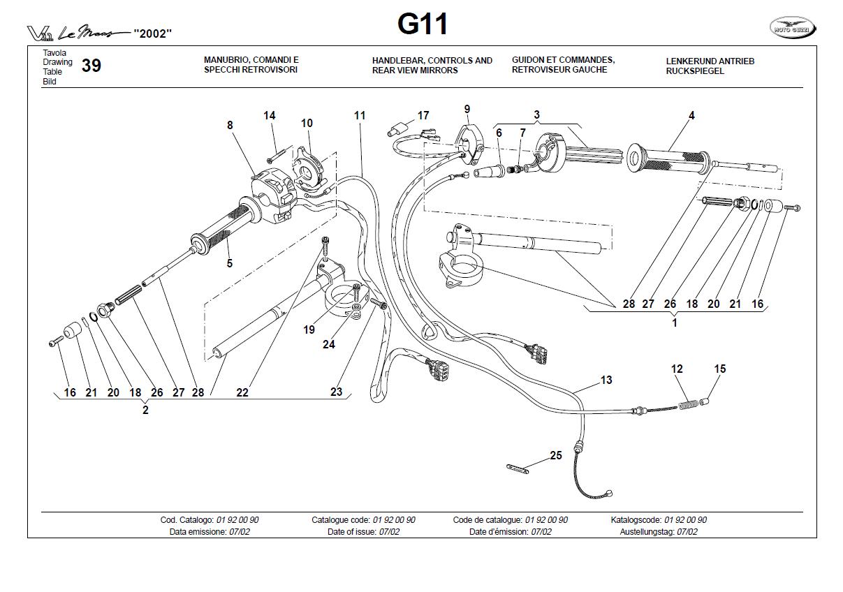

Tom M Posted August 17, 2010 Posted August 17, 2010 Here's the parts diagram for my LeMans. If your Sport is the same you will need to hold the end weight to remove the screw.

mdude Posted August 18, 2010 Posted August 18, 2010 2001 endweights are different. They are in one piece and unscrews as one with the hex. And they stick. I have tried to get my left one out for three years now, no Napoleon mirrors for me. And they are also quite heavy, so it will take a substantial replacement to make a difference. You'll get used to the vibes and the exciting "hands of a stranger"-syndrome that goes with the bike :-) As Warren Zevon put it: I'd rather feel bad than not feel anything at all.
