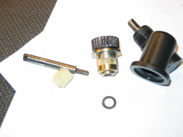

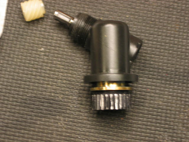

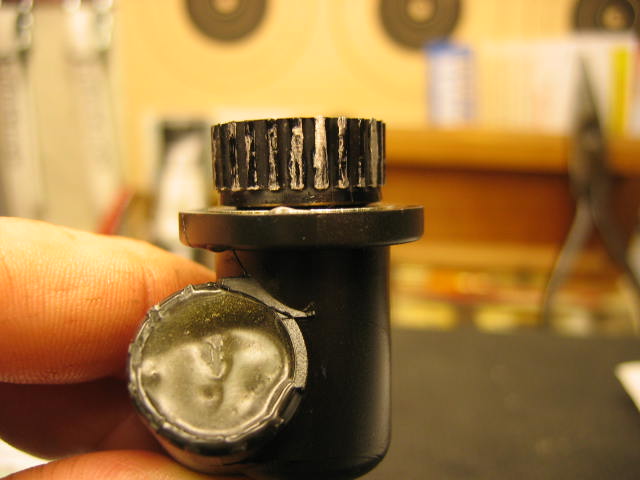

docc Posted September 11, 2010 Posted September 11, 2010 My new speedo with only 1700 miles has been wagging ever more in spite of reworking the lower drive and the cable lube. The moly lube was a mistake as now any seepage is gooey black. After about 100 miles today the speedo quit. Again. A close inspection reveals the brass insert for mounting the lower drive had walked out. The gears inside appear good. I'll use the Lubriplate this time (leftover from Lionel trains and the M14) and some adhesive to bond the brass plug into the drive. For reference, the brass recesses into the drive and no brass should be visible viewed perpendicularly:
docc Posted September 11, 2010 Posted September 11, 2010 And then, in my less than careful (read:frustrated ) disassembly, I find this Schnoor washer and my parts diagrams do not show the bevel drives.Where does it go?? EDIT/ January 07, 2013 - No doubt, the Schnoor washer is one of four from the caliper mounting bolts which showed up missing today upon disassembly for a fresh tire. Sloppy work on my part and a marathon search to find this post and edit. Now . . . where did I put that washer?
docc Posted September 11, 2010 Posted September 11, 2010 Brass mount pressed in (with a little JBWeld) and showing the epoxy over the pressed metal disc. 1
