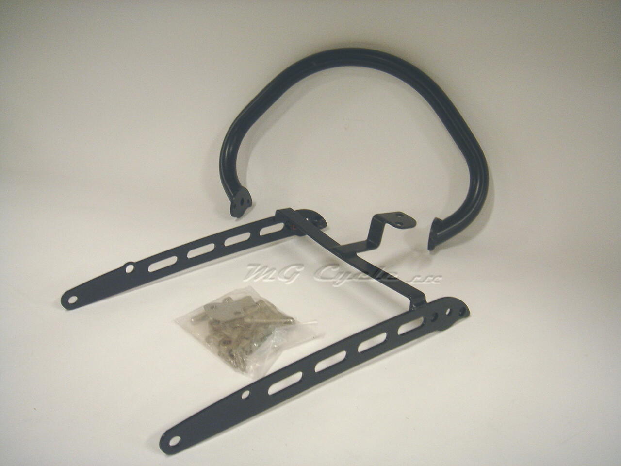

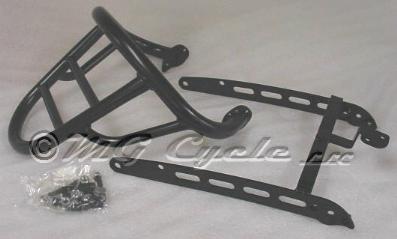

ponti_33609 Posted September 28, 2010 Posted September 28, 2010 Hi everyone, I want to go touring on my Scura, so need to fit a luggage rack. It needs to be strong enough to carry a small tent, but being a poser I don't want it to ruin the look of the bike. So far I've found two that might be OK - an aluminium one from Agostinis in Mandello, and one being sold by Stucchi Luigi (also Mandello)which I think might be a genuine Guzzi item. Has anyone had any experience of either of these 2 racks? Or anyone got any other recommendations? And anyone know if they are available in the UK? Cheers. Phil I opted for the MG rack although it stated cary weight is only about 7 pounds. I was told they actually can hold much more. For me, I rarely need more than a backpack or gym bag and I yhought it goes best with the lines of my bike. If you are looking potentially to carry more weight you may want the non Guzzi options. Bob
ponti_33609 Posted September 28, 2010 Posted September 28, 2010 Also, if I were buying again, I would like this buy this Stucci. You can detach the rack and add a grab bar if you choose when you are having a "poser" day. :>

Alfacity Posted June 18, 2021 Posted June 18, 2021 On 9/28/2010 at 1:26 PM, ponti_33609 said: I opted for the MG rack although it stated cary weight is only about 7 pounds. I was told they actually can hold much more. For me, I rarely need more than a backpack or gym bag and I yhought it goes best with the lines of my bike. If you are looking potentially to carry more weight you may want the non Guzzi options. Bob I have the same rack just purchased, it looks like you have another bracket under the bike as I’m not sure where it fits correctly
