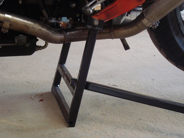

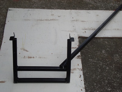

cash1000 Posted March 23, 2011 Share Posted March 23, 2011 I've made my own stand after being horrifyed at cost to get to New Zealand I used 25 x 25 square steel and 25 x 25 steel angle. Stand works best if you use a piece of 4 x 2 under side stand so bike stands up straighter when you are putting it on stand. I've attached photos. I've got a drawing but cant load it as size is to big. The measuremenst of stand are 320 height and 370mm wide with arm being 1140 long. Suggest you built a timber version to get angle of arm correct 1 Link to comment Share on other sites More sharing options...

Buzzard Posted March 23, 2011 Share Posted March 23, 2011 I've made my own stand after being horrifyed at cost to get to New Zealand I used 25 x 25 square steel and 25 x 25 steel angle. Stand works best if you use a piece of 4 x 2 under side stand so bike stands up straighter when you are putting it on stand.I've attached photos.I've got a drawing but cant load it as size is to big. The measuremenst of stand are 320 height and 370mm wide with arm being 1140 long. Suggest you built a timber version to get angle of arm correct I have found that, indeed, it helps to get the bike upright when putting it on a stand. I use wood under the side stand, as well as a motorcycle tie-down strap from the left handlebar to something substantial, a work bench in my case. I have had my wife try to hold the bike erect while placing the stand, it was just too frightening. Link to comment Share on other sites More sharing options...
