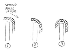

Baldini Posted November 25, 2003 Posted November 25, 2003 The bottom of the spring hooks over a plate. In use, as the plate moves, the end of the spring tends to slide sideways towards the edge of the plate. A larger radius will increase this tendency. I think spring needs to be hooked right over the plate, or at least the length of the short arm increased, to ensure retention if the radius is increased. Has anyone got one apart at the moment? KB, Cymru

Baldini Posted November 25, 2003 Posted November 25, 2003 Thanks Jaap... ...if only I had a brain To explain above... 1. Standard spring in use twists & pulls down towards the edge of plate. 2. Spring would slide on larger radius further across plate, pos off edge. 3. 180 bend would retain spring. KB, Cymru
