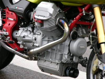

galaxiid Posted December 26, 2010 Posted December 26, 2010 Quite a neat V11 for sale, can anyone tell me if the oil filter placement is a special? Looks like it to me. Can't read German so can't tell what exactly else has been done to the bike. http://suchen.mobile.de/fahrzeuge/showDetails.html?lang=en&id=139226808&pageNumber=3&scopeId=MB&sortOption.sortBy=price.consumerGrossEuro&sortOption.sortOrder=ASCENDING&makeModelVariant1.makeId=18100&makeModelVariant1.modelDescription=v11&makeModelVariant1.searchInFreetext=false&makeModelVariant2.searchInFreetext=false&makeModelVariant3.searchInFreetext=false&vehicleCategory=Motorbike&segment=Motorbike&minFirstRegistrationDate=1980-01-01&siteId=GERMANY&negativeFeatures=EXPORT&damageUnrepaired=NO_DAMAGE_UNREPAIRED&export=NO_EXPORT&customerIdsAsString=&tabNumber=1
Admin Jaap Posted December 26, 2010 Posted December 26, 2010 It's the deep sump kit from Moto Spezial. I have it on my V11 too. Don't know if it's still available though. http://www.mgcycle.com/product_info.php?products_id=2784

Skeeve Posted December 28, 2010 Posted December 28, 2010 On 12/27/2010 at 8:08 PM, richard100t said: I really like the way the bike looks without the oil cooler in the front. Has anyone else done this modification? It seems to me that the oil cooler isnt necessary most of the time or almost all of the time for me. That inverted-pyramid sump was developed before the oil coolers started showing up: supposedly, with the deep Vee sump, the oil volume & surface area are both increased sufficiently that you can ditch the oil cooler for any uses less demanding than traversing the Sudan wfo...
Greybeard Posted December 28, 2010 Posted December 28, 2010 Why does MG say that sump doesn't fit spine frame models when by God there it is? under edit; I think I see why. No provision for the stock side stand?
Admin Jaap Posted December 29, 2010 Posted December 29, 2010 You can use the sidestand mount of a 1100 Sport or Daytona. That will fit.
