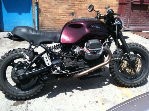

luhbo Posted January 3, 2011 Posted January 3, 2011 On 1/2/2011 at 7:20 PM, ScuRoo said: ...http://postimage.org/image/qkpe0ds4/..... This exhaust looks like a real good idea. The bike should hardly dig in deeper as up to this line, and then at once you have two nice grips to push it out again About the frame (should you really worry about this point): in 2005 I sent my V11 straight into the crash barrier, sliding though, nevertheless I had to pay for two segments and one support - besides a mark on one fork leg, a slightly damaged front rim and equally "modified" steering stops the V11 and especially the frame behaved as if this was it's daily business. The front fender was completely shattered of course - and for your purposes is a bit too short anyway. That's one part I'd replace for such a trip. hubert

ScuRoo Posted January 5, 2011 Posted January 5, 2011 Aah, here we go fella's... Would this V11 give it a go off-road? Crazy nutter! Ahee hee he... My link My link My link My link
Baldini Posted January 5, 2011 Author Posted January 5, 2011 On 1/5/2011 at 12:51 PM, ScuRoo said: Atlas mountains for sure but we are going for 2 weeks so could end up where-ever. How you getting to Morocco - Santander thru Spain to Gibralter, France/Spain? Have any of you been before? We took ferry to Santander, rode thru Spain to Gibralter then ferry to Ceuta. Rode S to Fes - Er-Rachidia & Erfoud, W to Ouarzazate & S to Zagora, then back through Marrakech/Casablanca & back up to Santander in (I think) around 3 weeks. N has a bit of hassle - avoid contact with drugs, or following strangers up blind alleys... I'd recommend getting down to the South if you can - S of the High Atlas - it's where the desert starts; the colours, the people, you get a sense of being on the edge of Africa. S of Erfoud you can find dunes (Erg Chebbi). Marrakech is quite a place. Todra Gorges worth visiting. In May I guess there may be some water running in the mountains, we went later in the year & had none. KB ScuRoo said: ...Would this V11 give it a go off-road? .... Built for looks - wouldn't go near sand or loose stuff with those open intakes....& you'd be on the cords before you got half way...
