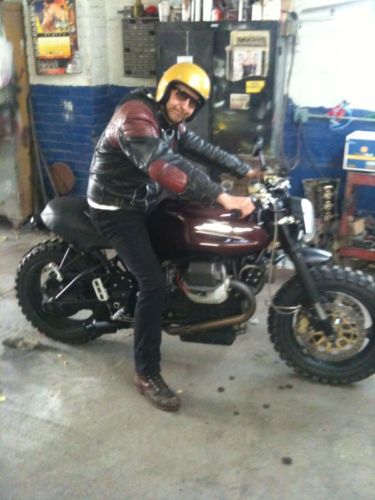

belfastguzzi Posted January 7, 2011 Posted January 7, 2011 On 1/5/2011 at 1:54 PM, ScuRoo said: Aah, here we go fella's... Would this V11 give it a go off-road? Crazy nutter! Ahee hee he... My link My link My link My link My guess is that the V11 in those pics is built as a road bike, not for off roading. The big tyres are just for looks. Are there any pics of it going through mud or up mountains etc? I wouldn't want a fat front tyre like that off road, or on a long tour. It's a city bike.
jrt Posted January 7, 2011 Posted January 7, 2011 When I made a set of shift/brake levers, I used soft aluminum for the toe-thingys (what's that part called?). My hope is/was that they would snap off and leave the main part of the lever intact- because that was much more involved to make. The toe-thingy is just a rod that's been drilled and tapped. honestly- the toe part is straight- the picture is off angle!
belfastguzzi Posted January 8, 2011 Posted January 8, 2011 The correct name is toe-thingammybubs, btw. Yes, that's good thinking too. What's the story behind this Jason? Just for fun or did the originals break? And here we go. Not how I would want to do it, but gotta empathise with the thrills that the guy has had making all this. Interestingy, despite ALL the mods and the huge weight, he didn't feel the need to fit fat tyres or knobbly tyres.
