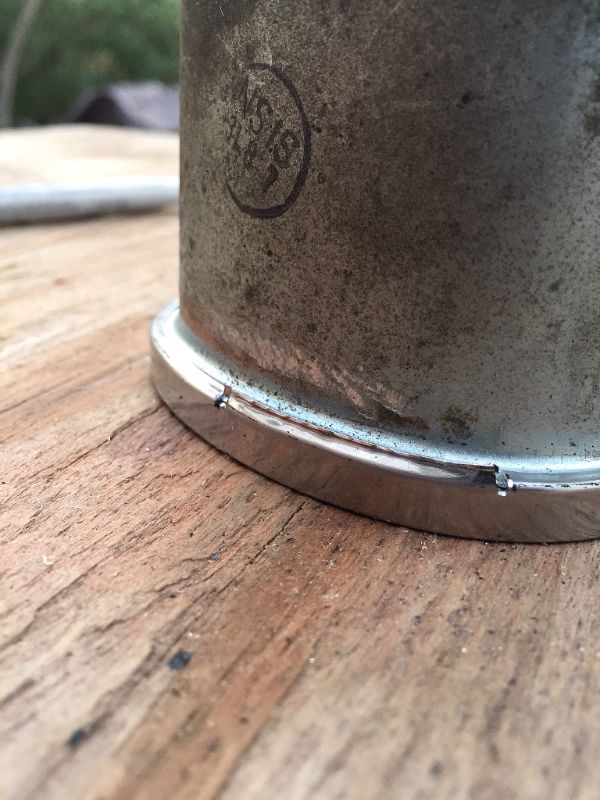

Here's how I got into a speedo recently
Using a dremel I cut through the retaining ring at the back where it would be hidden when in place by the instrument panel.
Cutting the metal into small lengths so that as they were almost straight they would bend up easily.
Putting everything back together, which I dont have a picture of, I held the assembled parts down onto a bench with a wood clamp & using a punch worked each strip of metal back into place.
A bead of clear silicon sealed the cuts & when mounted in the instrumental panel can't be seen.
