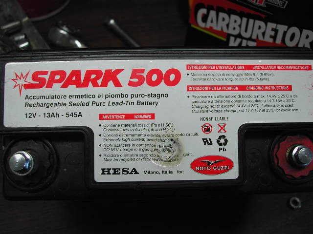

Buzzard Posted February 6, 2011 Posted February 6, 2011 I have just recently replaced the battery in my 2002 LeMans. This is the battery that came out. Did Guzzi dealers sell these in the USA, or is this the original?
Bogwopit Posted February 6, 2011 Posted February 6, 2011 Hi, my 2003 Le Mans has the same battery. I presume it is the original one. Andy.
vuzzi Posted February 6, 2011 Posted February 6, 2011 It sure is the original. Here is a topic about replacement options. http://www.v11lemans.com/forums/index.php?showtopic=4245\ I have the Odyssey, and it's doing great
Kiwi_Roy Posted February 7, 2011 Posted February 7, 2011 I have just recently replaced the battery in my 2002 LeMans. This is the battery that came out. Did Guzzi dealers sell these in the USA, or is this the original? When I replaced my Spark in my 2001 the dealer said it was the original The first Yuasa lasted Roy

Buzzard Posted February 7, 2011 Author Posted February 7, 2011 I am impressed with the original battery, about nine years of service. It would still hold a charge and start the bike, but the addition of heated hand grips brought out it's weakness. It was sucking up way too much amperage, turning it to heat I suppose. Using a digital volt meter, it held 12.7v resting. Start the bike up, and voltage would fluctuate wildly, getting to 14.2 at rather high rpm. Turn on the heated grips, and max voltage was 13.2v. I bought an inexpensive AGM battery offered on eBay, Leoch brand, from Gruberpowerservices, never heard of it, but $40 delivered. It was delivered fully charged, I still topped it off with the Battery Tender. While changing batteries, I added several grounding leads. The most needed was to the ECU. It is mounted in rubber feet with thread inserts, the mounting bolts do not ground it. The tiny ground strap provided was loose and corroded. I supplemented that, as well as adding a 12ga wire from the neg terminal to the engine block, thinking that it would compliment the added grounds from my voltage reg/rectifier to engine block. With the new battery and grounding, voltage comes up to 14.2v at 2000rpm, with or without the grip heaters on. Max voltage seems to be around 14.6, above 3000rpm. Lights are brighter, all systems are happy. I'll give this cheap battey a try, see how long it lasts. Interstate Batteries, as well as Batteries Plus, have AGM batteries at good prices. I have used both, in other bikes, with good results.
waspp Posted February 11, 2011 Posted February 11, 2011 The beloved optispark, my 2003 still has the original but this year may be its last!
