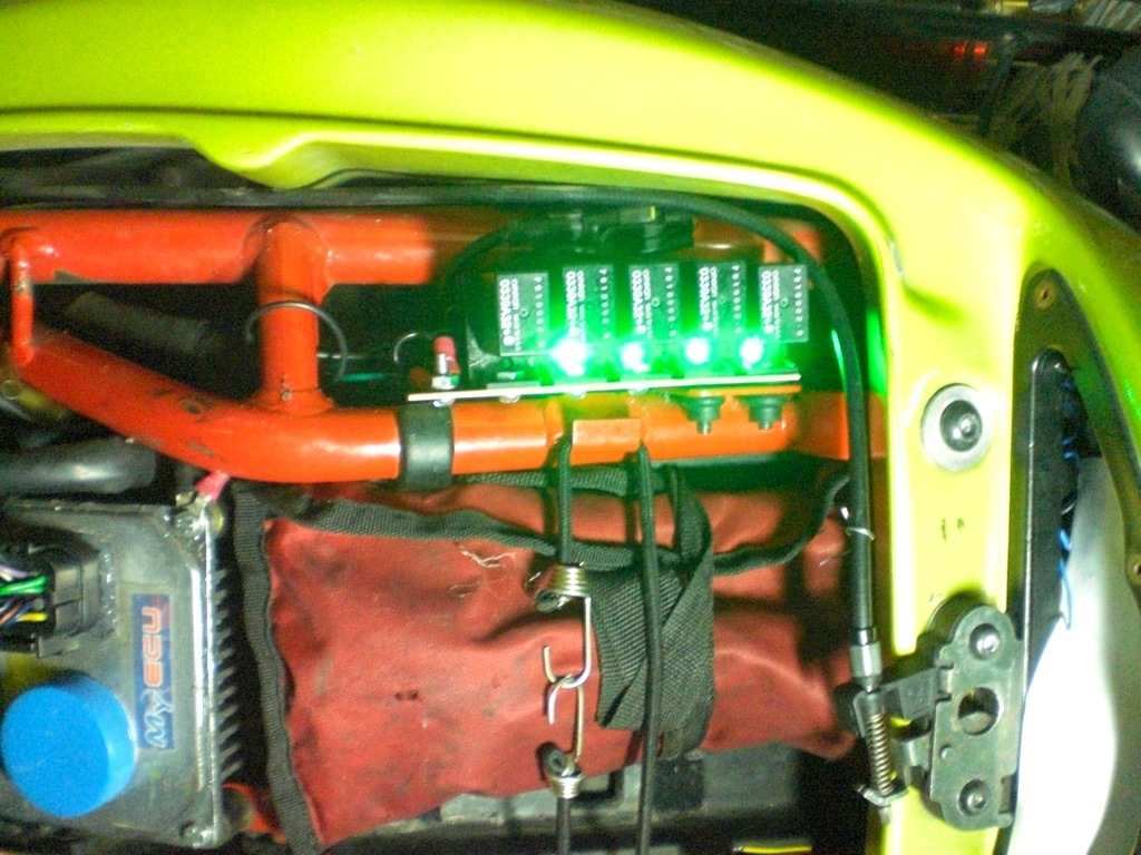

I added LEDs to my relay bases so I can tell at a glance which are made. Connected to the 87 contact the LED checks both the coil is energised and the contact is closed. Relay Base LEDs.pdf

The relays are easy to test, first of all you should measure something like 100 - 120 Ohms from one small pin (85) to the other (86) (the two outside ones), if you don't see that the coils toast. you should see zero Ohms from the flat horizontal (30) to the 3rd small pin (87A) and an open circuit from 30 to the other large pin (87). When you energize the coil with 12 V (30) to (87A) becomes open while (30) to (87) becomes zero.
When buying replacement relays buy all 5 pin variety.
