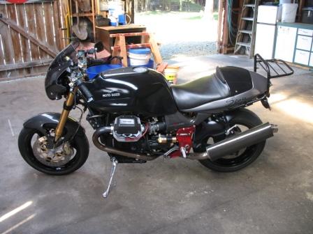

eas1rider Posted February 13, 2011 Posted February 13, 2011 Had all the carbon fibre parts on the Scura re sprayed last winter because the sun and elements had taken their toll. Was concerned about the durability of the end result, particularly on the carbon fibre "covers" that go over the exhaust cans on the Scura. Ended up using a product that is apparently used on chimney flues to give a gloss finish. Thus far all parts, including exhaust covers, look as they did ex paint shop. One problem that the painter encountered though was the presence of silicon embeded in some parts of the fibre strands. This makes adhesion of any kind of coating difficult. Most polishes etc contain silicon, something to be mindful of if you wish to re coat carbon fibre. After much cleaning with solvents and sanding back top coats he was able to get a good result, needless to say he was happy to see the back of me and my carbon fibre...
eas1rider Posted February 14, 2011 Posted February 14, 2011 Not sure how much "shine" the picture will show but hope it will give you an idea of the end result. Prior to this the carbon fibre was very dull and didn't help with the appearance of the bike at all.
