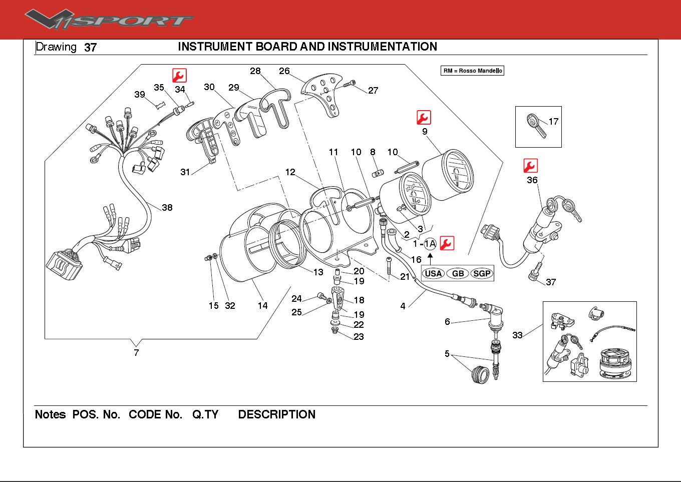

felix42o Posted February 16, 2011 Share Posted February 16, 2011 Well, after dealing with no tach (but a nice cup holder) for a while, I finally tracked down a working, used gauge at a reasonable price. Trouble is, I have somehow managed to mis-place the hardware for the attachement to the cluster. Here's the thing: The studs on the tach don't reach through the holes. So there must have been a few more pieces to lengthen the assembly. Anyone have any ideas? I never throw out ANYTHING mechanically related, so I have to hope I just forgot where these pieces are stashed, but for the life of me I can't find them in the pile. Link to comment Share on other sites More sharing options...
Admin Jaap Posted February 16, 2011 Share Posted February 16, 2011 Have you checked the drawings in the manual? Link to comment Share on other sites More sharing options...
Kiwi_Roy Posted February 16, 2011 Share Posted February 16, 2011 As Jaap points out the extension item 10 in the drawing If you have lost these you can make some out of 1/4 OD tubing tapped to 4mm. Link to comment Share on other sites More sharing options...
