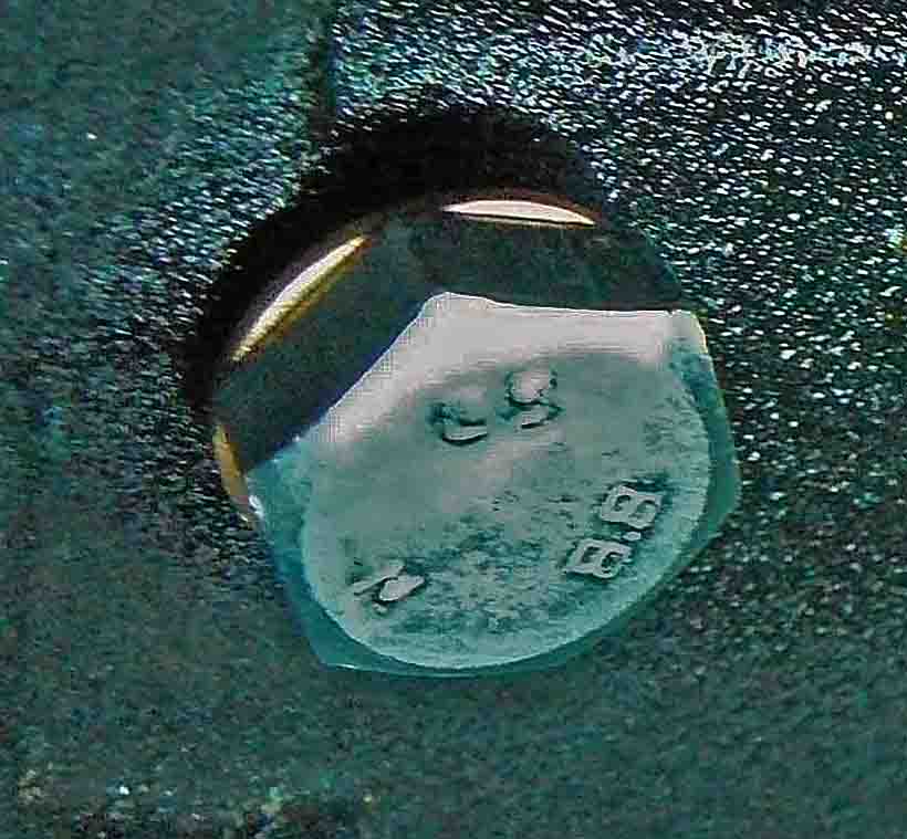

Camn Posted March 29, 2015 Share Posted March 29, 2015 One more millimeter puts it at 7/16", so I'm thinking of just tapping it to 7/16-20 and putting in a bolt and crush washer. Anyone tried this? I’ve done this with a help of a guy who I trusted. It is difficult to keep the bore 100% upright: if the bigger bolt is not level with the gearbox it is difficult to get the plug tight. I used copper gasket. How would you keep the chips out of the transmission caseOil out + open up the side cover as when changing the shift lever “magic spring” => it’s easy to clean everything up. The moisture on the picture does not come from the bolt ("new plug") - the reason was the front side of the back flange of the gearbox. This is why I ruined the threads from the plug in the first place. I thought the plug was leaking. Link to comment Share on other sites More sharing options...
