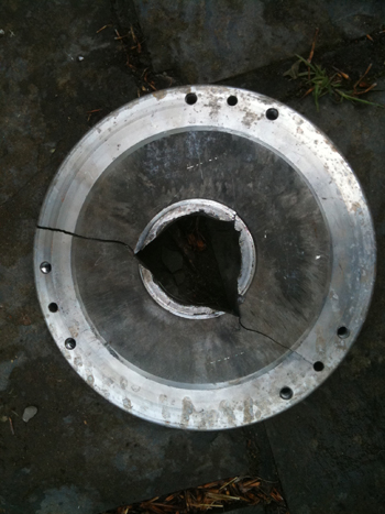

I wasn't sure where to put this, so this is a good as any. It had been noisy for as long as I can remember, and those who know have said that crack had been there a long time. Its been replaced by another single plate. The oroginal had about 14000 miles, and 8 years on it.

..and the other side....
That's not good :unsure:
How much other damage did you sustain?
Roy
You're saying this is a picture of a replacement flywheel? I've never heard of a replacement breaking up in the middle like that. Makes me think theres something else wrong thats causing this sort of damage. You arent letting BFG's mechanic work on it are you? :luigi:
That looks very similar to the damage john's suffered - ripped the centre out. Lucky to get away with that & no collateral damage - we've seen others where whole unit disintegrated & smashed it's way out through casings whilst in use.
You replaced it with a stock Scura/Tenni Ali flywheel :o ?

The flywheel in the picture appears to be steel also.
another failure to learn from the past.. the first version of the Convert came with a pressed steel plate for a fly wheel, it was about 3 pounds and thin.. the same thing happened to them where they spun the middle right out, the fix was a 15 pound flywheel with starting gear in one piece.
this is the thin one I modded to trigger the crank sensor on a EV motor,
and here's what the other one looked like,

Two flywheels replaced at about those mileages. Forget the 8 years. Caught the first before major damage.
The second went without much warning- Destroying the gearbox and creating a Moto Guzzi with a wet clutch.
My personal recommendation would be to put a twin plate on it and be done with it. Sourcing a replacement gearbox
could be a tedious and expensive exercise.

If you peep through the timing inspection hole in the bell housing you will be able to see the flywheel & what it is made of.
This is a known problem with the OME Scura flywheels & there is a ton of stuff relating to it on this site.
It would be v interesting to know what Guzzi supplied as replacement Tenni flywheel, & if it differed from the original. Some components (but not, as I understand, the flywheel) of Scura (& presumably Tenni) clutch were sourced from a company called RAM. I replaced my Scura clutch assembly with a complete RAM unit inc alu flywheel. I guess it is possible that any replacement could be sourced by Guzzi from RAM rather than OME that is known to be problematic? As Docc suggested, did Mecca have part #'s - on invoice perhaps?
When I fitted RAM unit I had a mismatch between dimensions of clutch pushrod & clutch centre button resolved by using OME button in RAM clutch. Was this the problem your mechanic had? Was whole clutch assy replaced or just flywheel?
The flywheel in your photos appears to be the original alu one.

Two flywheels replaced at about those mileages. ..
Flywheel 1 was original, what was flywheel 2 - a Guzzi replacement part?

The whole assembly was replaced, as that's all that was offered. Looking into the peephole, it appears to be aluminium. I've got the remains of the old assembly and RAM is written on at least one of the parts, but not the flywheel.

If it is a complete ram kit, should I be worried of a repeat in about 10,000 miles?( I'm assuming the ram flywheel is aluminium?)
My RAM clutch is on 6,500 miles ...still working. I can't comment on ultimate longevity. RAM clutches have been around a long time & I have not heard of this problem occurring with them. I have had one in my Tonti for years - but it doesn't really do much mileage.
I do not know why original flywheel fails - but it always seems to fail at the same point: around the edge of the centre washer & radial cracks outward. The edge of the washer is a stress raiser. RAM instructions specify side of washer to face flywheel. Incorrectly torqued bolts would be an issue. Was your clutch noisy compared with other single plates? As I said, John O'Sullivan's (wherefore art thou John?) flwheel also tore it's centre out, & was very noisy compared with mine & BFG's - I remember waiting at lights & you could hear it over the noise of both our bikes.
As you pointed out some parts of the OME clutch are RAM & stamped as such - but there are dimensional differences between the OME flywheel & the RAM flywheel. It is my understanding that the flywheel is not a RAM part. It has been said to me that the flywheel was sourced elsewhere (why?). But wether it's an assembly issue, materials or manufacture - I dunno.
