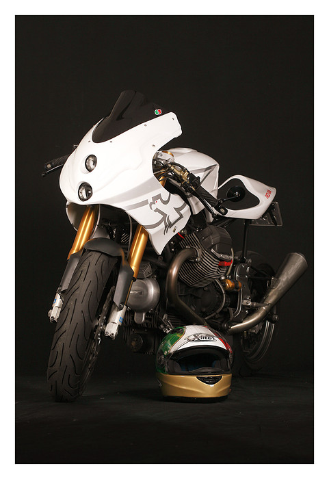

Admin Jaap Posted May 25, 2011 Author Posted May 25, 2011 It used to be a 2001 red/grey V11 LeMans Now it looks like this:
gstallons Posted May 25, 2011 Posted May 25, 2011 Looks good. Show some more pictures.I like the Eagle.

Mortimer Posted June 2, 2011 Posted June 2, 2011 It used to be a 2001 red/grey V11 LeMans Now it looks like this: Whoa!! It's a V11 999!! Nice job. I'd like to see what you did behind that front fairing. Did you use a headlight from a Duc? By the way, I just cleaned up some popping and crappy fueling on a 97 Sport 1100 I just acquired. This was fixed by turning in the bleed screws on the throttle bodies and richening up the adjustment pot in the ECU.
Admin Jaap Posted June 2, 2011 Author Posted June 2, 2011 Hi Mortimer, welcome to the forum! Check out this thread for more info on this project: http://www.v11lemans.com/forums/index.php?showtopic=15561&st=0
