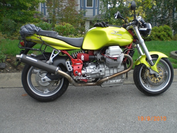

Kiwi_Roy Posted May 28, 2011 Posted May 28, 2011 The pods do look cool IMHO but certainly narrow down the power band. If you decide to go that way get the ones with a slight angle, I bought straight ones. The large cable loom you can see has since been re-routed up under the seat with the excess where the air box used to be. This was done without disconnecting anything. As I said they do narrow down the power band, I have since modified the arrangement by extending the pods using the original air box rubber arrangement like a velocity stack, The pods slipped inside and I secured them with a couple of self tappers. That seemed to restore the power band to where it was. I rode in the rain a lot last year, when I changed the oil this season I found a small pocket of emulsified oil in the sump, I don't know if having the pods caused that. Cheers Roy

Kiwi_Roy Posted May 28, 2011 Posted May 28, 2011 Where did you end up mounting the sensor that's in the airbox? First of all I just ty-wraped it under the tank, seemed to be OK but after some thought I extended it out into the fresh air. I cut the sensor off the plug and soldered a couple of feet of wire between it and the plug. This avoided having to open the loom. I just ty-wraped it to one of the frame tubes I extended the breather hose down by the gear change and finished it off with a crankcase breather from K&N. Roy
