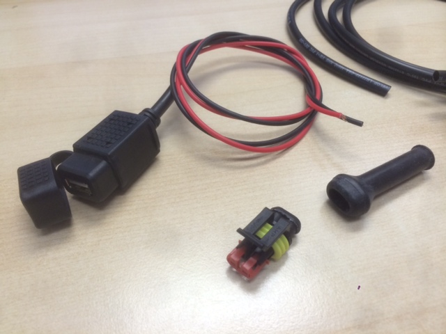

danl Posted September 11, 2015 Posted September 11, 2015 I like it too! I've been planning to add a switched USB connector for my phone using that connector. The AMP connector and sleeving just arrived on my desk today. 1
sp838 Posted September 11, 2015 Posted September 11, 2015 Genius! Who did you order that from? I want one too.

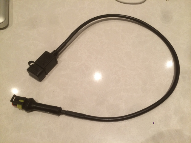

danl Posted September 12, 2015 Posted September 12, 2015 The USB cable is from Amazon. I can't find the single port version anymore. Here is a dual port version: http://www.amazon.com/gp/product/B00SL0HHFC?psc=1&redirect=true&ref_=oh_aui_detailpage_o03_s00 And another one that looks like the one I have, just packaged a little differently: http://www.amazon.com/Weatherproof-Charger-Socket-Bare-Wire/dp/B00HQ5JS7I The one I bought came with an overmolded cable and fused ring terminal connections. I had already trimmed it to length and removed the outer jacket when I took that picture. The AMP Superseal connector, boot, sleeving and heat shrink came from Cycle Terminal: http://www.cycleterminal.com/index.htmlhttp://www.cycleterminal.com/index.html I'm planning to mount it behind the headlight, inside the left mounting ear. I'll post some pictures when I'm finished.

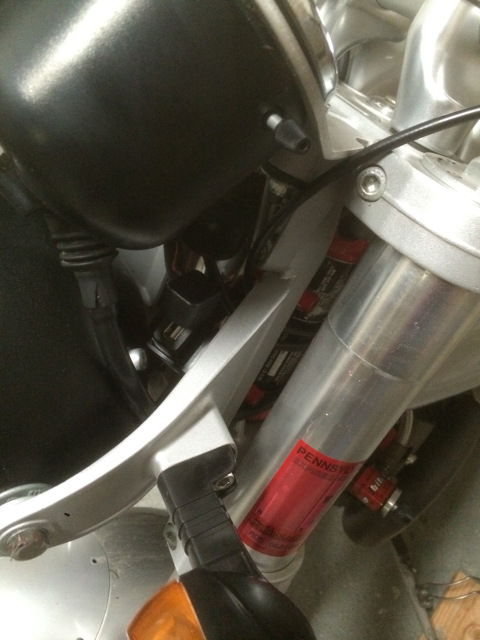

danl Posted September 17, 2015 Posted September 17, 2015 Here are a couple photos of the finished product. Plugged right in to the unused petcock connector and worked as expected. This was the least intrusive electrical mod I've done! The USB Port behind the headlight is barely visible at quick glance.
