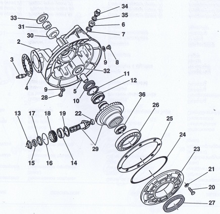

Baldini Posted June 14, 2011 Posted June 14, 2011 On 6/13/2011 at 4:57 PM, rebelpacket said: I'm sorry, but I'm not following the different terms being used here.... Quote ... lube the needle bearing on the drive side with bearing grease.... That's 30 & 31 in this diagram. Washer talked about is 33.

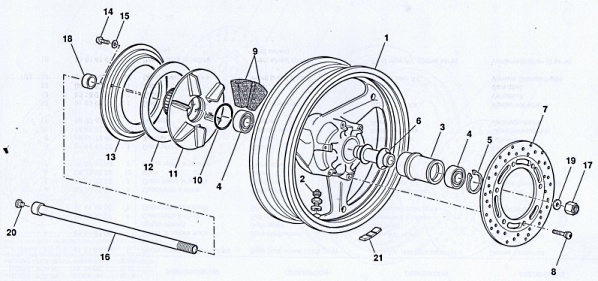

Baldini Posted June 14, 2011 Posted June 14, 2011 On 6/13/2011 at 4:57 PM, rebelpacket said: Quote I just measured the distance between registers and had a steel spacer made to match.... (1)...What do you mean when you say "between registers"? (2)...Is it happening because of the spacer in the wheel between the two bearings?... (1) I presume "between registers" refers to between the faces that the bearings sit up against in the hub. (2) Yes this spacer, part no 6 in diagram.

rebelpacket Posted June 14, 2011 Author Posted June 14, 2011 On 6/14/2011 at 4:21 PM, Baldini said: (1) I presume "between registers" refers to between the faces that the bearings sit up against in the hub. (2) Yes this spacer, part no 6 in diagram. Perfect! Thank you very much for taking the time to explain that to me Baldini. I completely understand the scope of the failure now. Sadly, I already drifted my bearings in, and as I don't have a spare set, I'm going to wait until this one gets mucky until I replace it and remeasure the spacer for machining. Might as well get some miles on this set until it starts to slop out. Thanks!

Baldini Posted June 14, 2011 Posted June 14, 2011 On 6/14/2011 at 5:10 PM, rebelpacket said: ...I'm going to wait until this one gets mucky until I replace it and remeasure the spacer for machining. Might as well get some miles on this set until it starts to slop out... It may be that the spacer is OK & bearings failed for some other reason. But, if the spacer is too short & the bearing inner/outer races are consequently misaligned when axle is tightened - don't plan on a long trip! Good luck! KB

The Monkey Posted June 19, 2011 Posted June 19, 2011 On 6/14/2011 at 5:10 PM, rebelpacket said: On 6/14/2011 at 4:21 PM, Baldini said: (1) I presume "between registers" refers to between the faces that the bearings sit up against in the hub. (2) Yes this spacer, part no 6 in diagram. Perfect! Thank you very much for taking the time to explain that to me Baldini. I completely understand the scope of the failure now. Sadly, I already drifted my bearings in, and as I don't have a spare set, I'm going to wait until this one gets mucky until I replace it and remeasure the spacer for machining. Might as well get some miles on this set until it starts to slop out. Thanks! Thank you for clarifying Baldini, additionally when negotiating the front bearing set the spacer the bearing rides on (port side) is also made of inferior material, check it as it may need building up then turning to bring it up to the hardness required. How I came up with the measurement regarding material to use as a spacer is merely based upon experience. I chose steel as that was compliant with the rest of the metal in the "stack" aluminum would be twice the guage and bulky. Stainless is too soft, better to parkarize the steel. There is a great thread somewhere dealing with recommendation regarding crush and the axle spacer, look it up. Oh yeah pop out that bearing and measure space between registers and make damn good and sure the internal races aren't being squeezed due to a spacer too short!
gstallons Posted July 9, 2011 Posted July 9, 2011 Why didn't I think of this !!!! I was at a buddy's shop today & he was explaining how he set-up front and rear wheel bearings. He told me he assembled the spacer, bearings,etc... After that he took a piece of all-thread the right size & length and used it for his new axle.Then you use SAE flat washers ( because they are narrow) and nuts, you assemble and torque the nuts to 50' lbs. If the bearings spin freely everything is o.k... If not it is time to do something. Either a new spacer or tapping e.g. seating the wheel bearings into the hub for 0 lateral pressure because roller bearings cannot tolerate this. When installing bearings you want to make sure the bearing is seated in the hub and against the spacer. That is why you are doing this to make sure NOTHING happens on the road !
