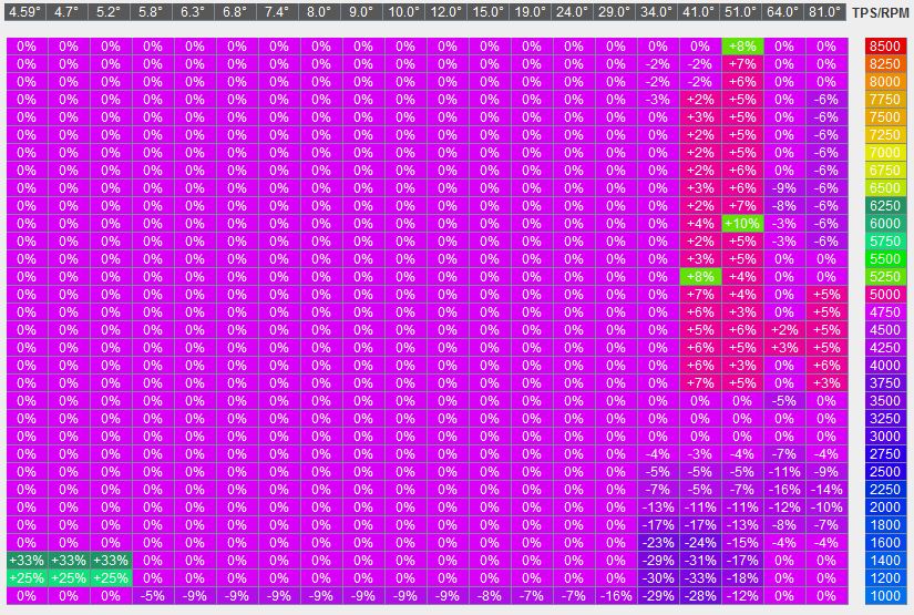

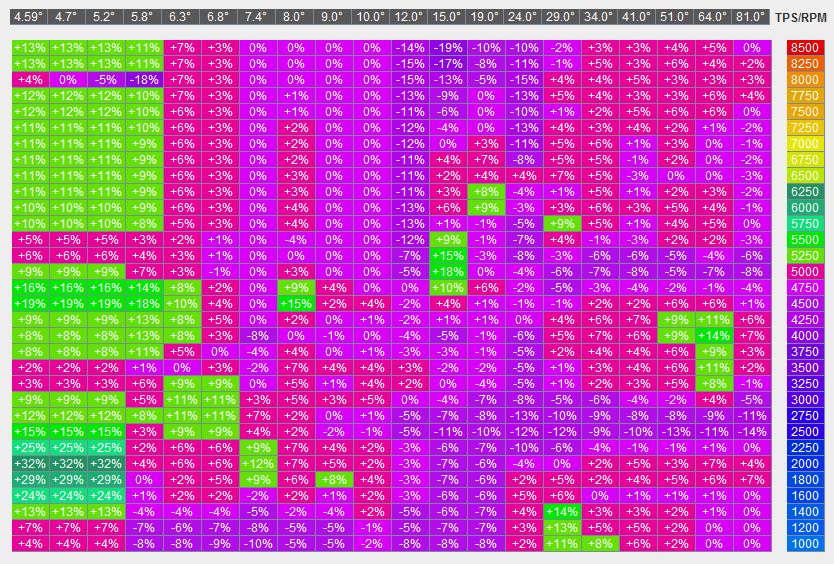

Paul Minnaert Posted September 8, 2011 Posted September 8, 2011 Pete, here a comparision between the stelvio 52 map and griso 68 map, +10 means the 68map has 10% more fuel injection time. Ignition time doesn't make much between maps. And yes there is almos free software to edit 5am maps, even switch lambda off. fuel ignition

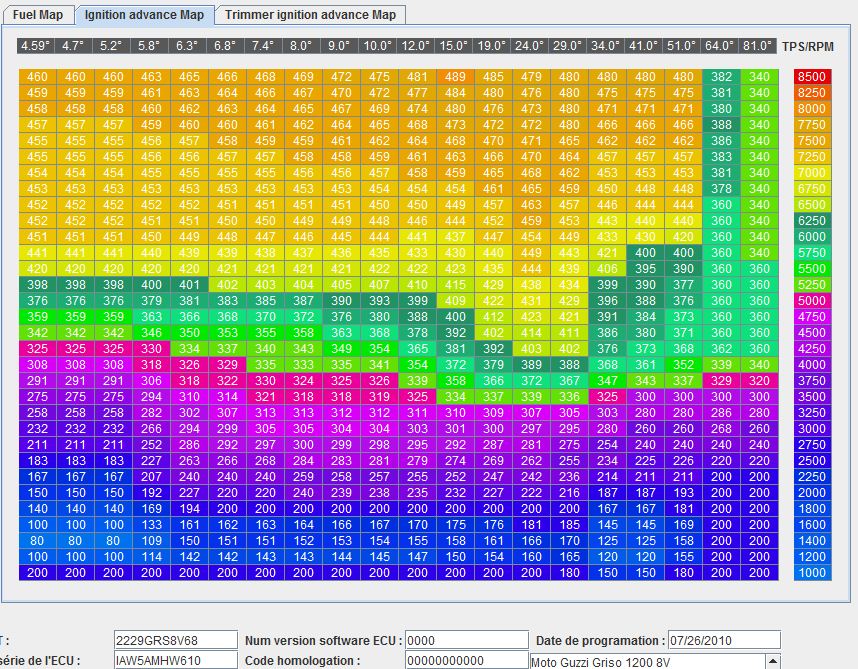

luhbo Posted September 9, 2011 Posted September 9, 2011 Could you post a absolut value spark map, please? The actual one. Thx, Hubert
Paul Minnaert Posted September 9, 2011 Posted September 9, 2011 Could you post a absolut value spark map, please? The actual one. Thx, Hubert These are values the marelli counts with
luhbo Posted September 10, 2011 Posted September 10, 2011 ...These are values the marelli counts with Thank you, Paul, most helpful. You know what the numbers stand for?
Paul Minnaert Posted September 10, 2011 Posted September 10, 2011 ...These are values the marelli counts with Thank you, Paul, most helpful. You know what the numbers stand for? no, but since you are interested, you can download the map editor free, here: http://ecmtool.free.fr/ and enough maps to fill your whole weekend: http://jpl250rs.perso.sfr.fr/MAPS/ and the forum topic about it: http://ducatidiag.xooit.com/t556-ECM-Outils-de-customisation-de-maps.htm
