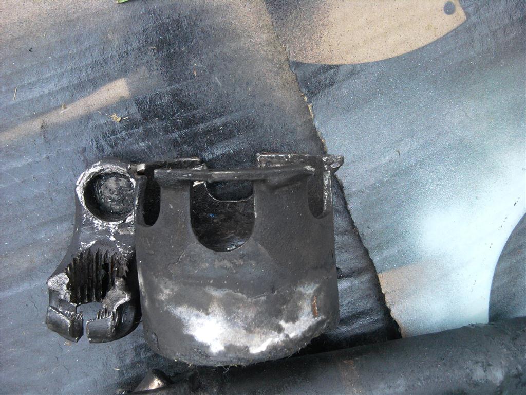

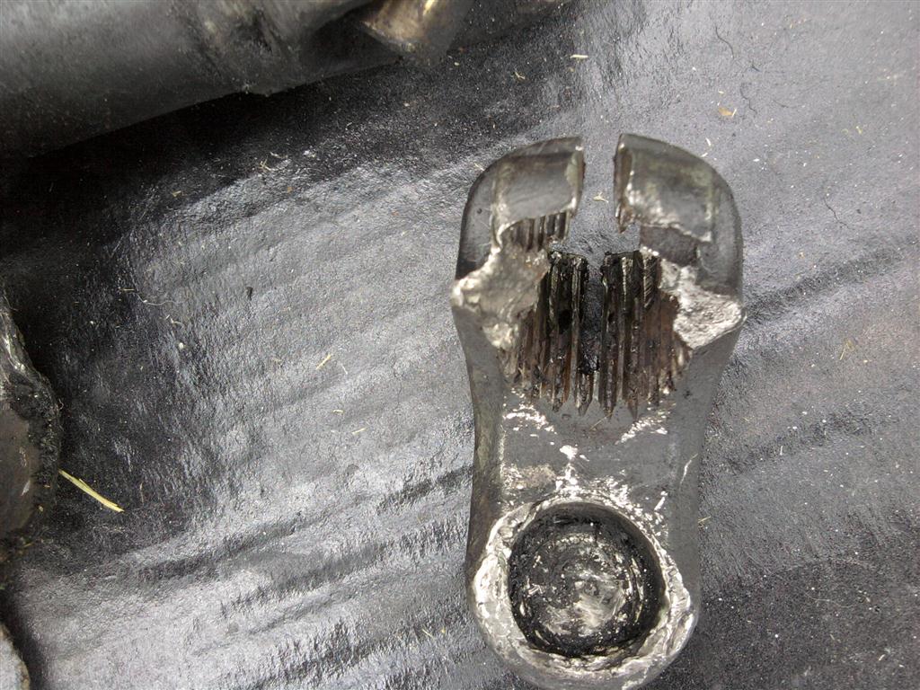

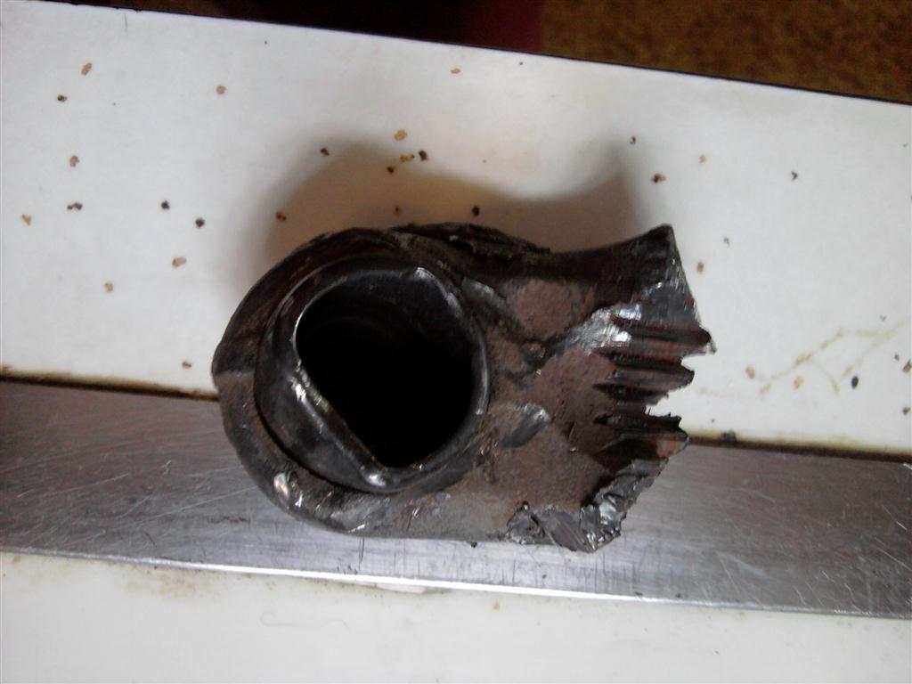

I was out for a nice relaxing ride last night when I started to hear this weird ratting sound. I was only doing about 50mph and not hot rodding at all so I thought this is odd, did I run over something? Then it got real bad real fast. I pulled over to the side of the road to find that my front u joint had broken, taking the cover with it and pretty much trashing the front shaft yoke in the process.
If anyone has, or knows where I can get a new shaft please PM me.
I'll post pictures of it later, its hot and I'm still pissed about it. I greased that *^&^%*%* joint every damn year.

I would like to see the damage and the boken parts, this is the first one breaking I know of. Pictures please!
I'd like to post the pictures but I think I'll need a moderator so that I dont have to crop them down too small. If one of the moderators will pm me I'll send all the pics of the damages for viewing here.

I appreciate the advice, BUT I need a whole new driveshaft at the moment because the old one got mangled up with the bits of the broken u joint. Unfortunately there arent as many v11's out there as there are Hondas, so it will just take a little longer to get the used parts that I need. When I do get them I'll definitely keep all of you up to date.
Google driveshaft or u-joint repairs for V11 ...........After a better look, that is messed up !
