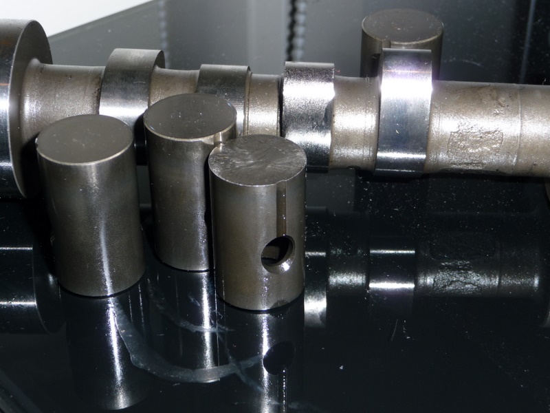

Mikuzzi Posted October 18, 2011 Author Posted October 18, 2011 Got the bike back and is running well. I also got back the offending bits of innards so thought I'd post a pic for interest. If this was a bad batch, most would probably have failed by now. I was staggered at how much material had worn off both the cam lobe and the tappet (lifter? what's the right term?). There was some talk at the workshop that inadequate lubrication in the area may also be an issue, based on the fact that the replacement cam had much larger, repositioned oil galleys.

madleemark Posted October 18, 2011 Posted October 18, 2011 Hi, its very poor to have worn so badly at such low mileage, hope your new parts last a lot longer, was this problem just on 2003/2004 bikes? whenever i see this sort of thing i allways worry about my own bikes internals.
emry Posted October 18, 2011 Posted October 18, 2011 HA! Sorry not realy laughing at you, but vendor issues have been problematic for several OEM's. For example Yamaha's XV1900 engines had similar failures early on, improper heat treatment of the lifter base was the cause (vender). Made a real mess out of the cam's too. Normally customers would only bring them in once the pushrod would fall out of place and it would turn into a single! Hopefully the "new" inventory has better quality control. <_ factories realy do want to right but sometimes the cost of doing business in a conference room can be overwhelming. good companies fix those problems fast and take care customers long run bad companies.... well normally not make it as companies. economies scale apply.> Hope your repairs provide you with ALOT more miles then before.
