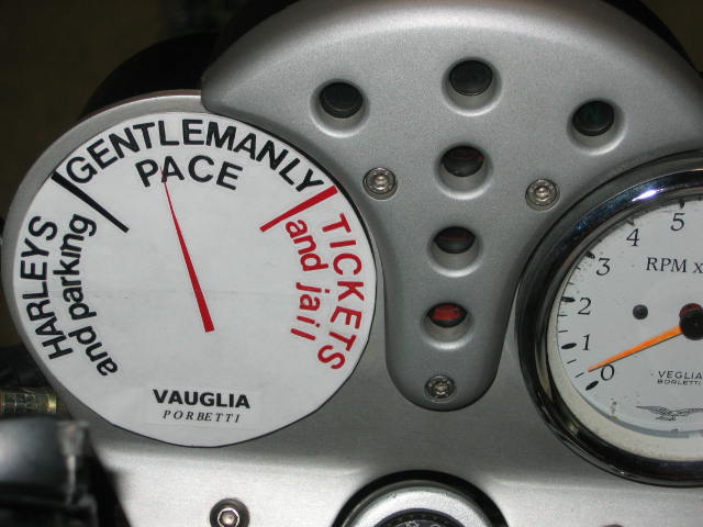

docc Posted September 21, 2011 Posted September 21, 2011 AT almost 80,000 miles, I'm on my third Veglia. The first under warranty when it started wagging at highway speed and the second when the trip odometer locked up. $298.53 (USD) shipped from MI in Seattle in July, 2010.With the Garmin ZUMO in the mount, I'm not sure I would repair another Veglia. The GPS shows speed, odometer, fuel tank range and is lighted. It has "dashboard" functions that would entirely supplement the original speedometer.Of course, there are always these solutions:
