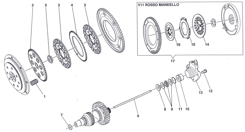

Baldini Posted November 8, 2011 Posted November 8, 2011 Yes, all Calis were 5 speeds as were all 1100Sports, Daytonas, Centauros etc. V11 6speed gearbox is not used in anything else. Clutch hub (variously called clutch centre, centre boss, clutch gear etc) is #6 in second diagram. I'm not sure about compatability of hubs. Also not sure 5 & 6 speed clutch pushrods (#6 in first diag) are interchangable - I doubt it given 6 speed is shorter & pushrod runs thru length of box - check length & diameter...before you assemble it! KB
pete roper Posted November 8, 2011 Posted November 8, 2011 Good point Keith, I'm pretty certain the single and twin plate clutches use different pushrods but I could be wrong. Make sure you check it.
