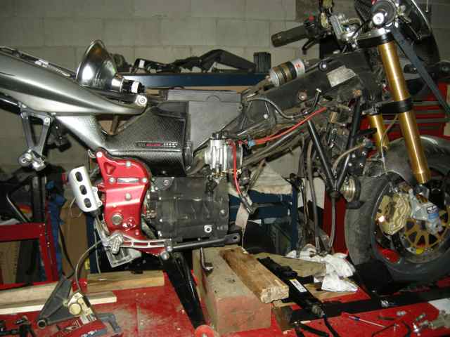

mznyc Posted April 21, 2012 Author Posted April 21, 2012 **Update** I lifted rear of the bike with factory stand,while the front sits in a chock and bars strapped to lift. Removed rear wheel,swing arm,disconnected wiring,.Once I got the transmission free and mounts it just took a car jack under the sump to get the right height to slide the motor free of the studs.just a slight up and down till I got it right.once free a little wiggling and pulled sump towards my body with right head swinging underneath spine.carried to bench a few feet and wasn't as heavy as I expected.im 6'1" 195 lbs so anyone reasonably strong should be able to move it.keep in mind bike was at chest level while on a lift.from the floor this would be much more difficult.to get it back in I have a floor stand lift that I'll pick up frame,put engine on a wood block and lower frame to it.when I get to a faster connection at work this weekend I'll upload some pics. More to follow,......

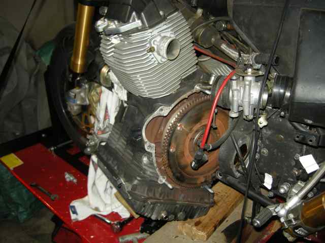

luhbo Posted April 22, 2012 Posted April 22, 2012 2 and 6 are nice ones! What's on 2? Mice? And on 6? Did the screws scrape the engine housing? Hubert
mznyc Posted April 23, 2012 Author Posted April 23, 2012 No scraping,came out clean,just stripped when trying to remove.My crappy Craftsman wrenches strike again.Should have taken JRT's advice and heated bolts first!Im gonna chuck the whole single plate set up so not worrying too much about it's condition.Yup mice,my house is out in the woods and she's mostly been sitting in the shed for a year and a half since the shifting been shite,so a mouse family moved in,bummer as that filter had very little miles on it. The plan is to put in clutch,add and xtra ground for regulator,small fusebox,heated grips,clean all wires,frame,engine.grease all bearings and driveshaft.flush all fluids.balance tb's,check valve lash,TPS,fuel,air filters,new tires,check brake pads ,service calipers,repaint alt cover.Whew! Over the summer I'll do a front end service,check grease head bearings,dump fork fluid . Anyone have a recommendation for cleaning the engine and trans housing?
