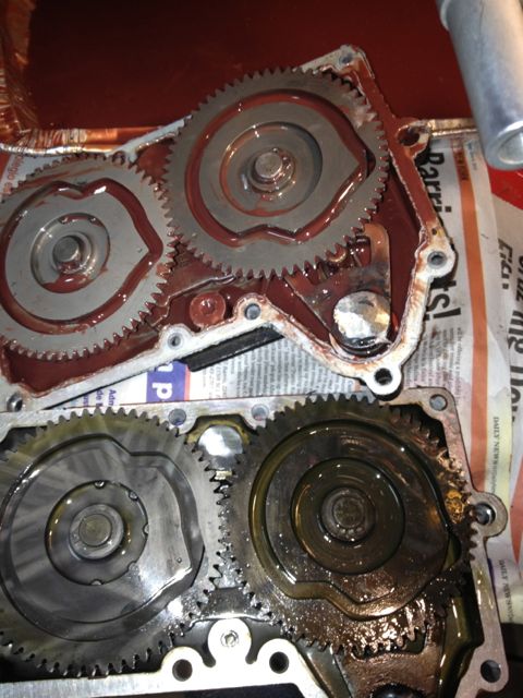

What you could do is remove the gearbox' sidecover and check whether the shifting forks/pinions move freely. From friends I've heard of 'dog tranny from factory', so that's not too unlikely. In good ones the internals begin to move as soon as you tilt the box a little bit. Having the side cover down you can check this one as well, whether the shifting wheels (and the mechanism behind them)turn smoothly or not.

Im gonna pull off cover again and see if anything looks amiss that I may have missed on previous attempts.If it is the dogs as has been suggested here before, can I see them with the cover off.Not sure what they'll look like.
If I had a known good box on hand I would slap that pre-selector cover on mine to see if it's that.If not,install the box.If I cant find a used one the next few months I'll have to send it off to Harper's as they're the only known reputable shop that I could find that rebuild 6-speeds.

Got a used box from Mark at Moto Guzzi Classics.Says it was off a crashed front end ,
low mileage 03.Since he's in Ca, is this any of ours?
Selector wheels side by side look the same.Old box has Redline,new one, something else.
My theory is the box or the pre-selector is bad.The easiest thing to do is put the new cover on the existing box and see what happens.If it doesnt help,I'll drop the new box in and cross my fingers,........
To be continued,........
Hmm,Got the "New" pre-selector cover on and a short test ride.No problems and I tried to short-shift it but it wouldn't hit a false neutral.I'll get it out tomorrow for a longer ride as it'll be warmer and I'll get her nice and hot as it seems the problem appears when that happens.
If it is the cover,either something went out of spec or adjustment.It started to miss shifts before I opened it and had been a mostly reliable shifter for several seasons,so I'll eliminate anything I might have done when I pulled the cover.

So the problem may have been the pre-selector assembly all along.The new one appeared to be the same and alignment of marks identical,but something must have been wrong in there.

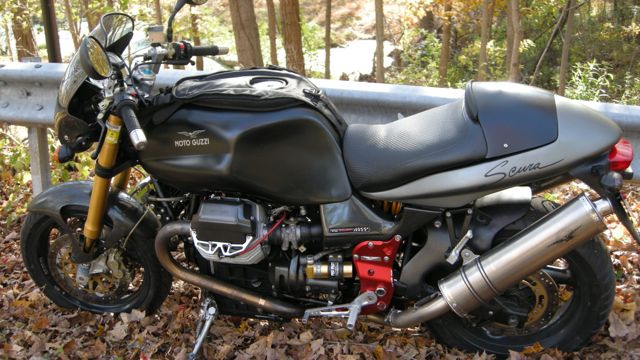

I'll report back after a few more long rides,hopefully I can get a couple in as our season is coming to an end,....Guzzi RT16 Fall 12.jpg

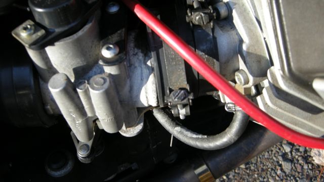

Another 5-6 hr ride and problem free,1 missed shift but relate that to rider laziness.Changed plugs,gaped valves while motor was out and bike is running awesome with a little burble/popping off throttle.Still have as yet to sync TB and set TPS which should correct that.About 20 miles from home she started dieing below 4 K.Pulled over and found a loose TB boot.There was a weird sound ,like a squeaky belt,as soon as I restored boot noise went away and bike ran fine again.What would cause this noise?
Problem had always shown itself when warmed up,and she was definitely up to temp.

All of the things you mentioned I tried and still had the same results,if you havent yet,I know it's lengthly,but go back and read this thread.I dont know what went wrong in the pre-selector assembly.It looks fine and looks the same as the "new" one.I'm going to send it to a Guzzi trany specialist ,Charlie Cole and get his thoughts.He generally only works on 5-speeds,but Im gonna ask if he sees anything out of place.It's very simple,just a couple wheels,3 springs,a pawl arm and a couple other components.The parts individually are expensive,and finding just a cover assembly alone is nearly impossible.Most people parting a bike sell the cover with the box,which is what I did.I would remove it and take a look and see if anything looks out of place.I wish I could tell you what was wrong in the old cover,all I know is that with all the changes I did,only putting on a different cover corrected the problem.If you do get in there start a thread and the crazies will offer their opinions. :grin:

The squeaky noise that you heard was probably air being sucked through a small gap between your loose TB and the rubber boot. I'd guess that you would hear it most while engine braking.
