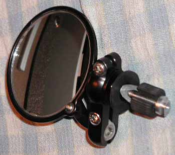

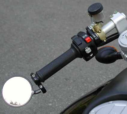

Guest John Sears Posted August 29, 2002 Share Posted August 29, 2002 Following are photos (in separate replies) of two options for mirrors for the V11 variants: the CRG mirror setup for mounting directly to the bar ends of the V11, and a different way to mount Napoleans while still using bar-end weights. For the CRGs, I used the CRG bar-end adapter kit, but modified it slightly to try to minimize the effects of vibration. The modification consists mainly of not using the aluminum wedges and sleeves that come with the kit, and instead, using the rubber expanders from a set of Cat-Eye mountain bike bar-end mirrors (which would probably also work well on the V11 - a lot cheaper, too!). I had to cut a slit in the Cat-Eye expander, to slip it over the threaded screw shaft of the CRG adapter. I reversed the end-piece that screws onto the threaded screw of the CRG, so as to have the flat side of it pressing against the rubber expander. I also added a 7/16" flat rubber washer from Home Depot to the adapter, placed so it fits between the adapter and the end of the handlebar, to provide additional vibe damping for the mirror. I also bonded the mirror glass to the frame with contact adhesive, to keep the glass from vibrating loose. That's it: just slide the adapter into the bar end, (it fits just right with the Cat-Eye expander), and start tightening. As the screw tightens, it compresses the rubber expander, which presses out into the inside of the handlebar tube. Keep screwing it in until it's tight, and you're ready to go. The photos show the setup ready to install, and installed on one bar end. The CRGs are a little expensive, but very well made, and they give a bright, wide view, although a little small. The mirrors are staying tight and the images are stable most of the time, but will jitter a little at certain revs. So far, I like it. There’s not much to say about the Napolean installation: just mount them as shown using the thru-holes in the clutch and brake levers. The stock Napolean screws and nuts work perfectly. It’s very much like having bar-end mirrors, as they are low and give you a wide-open view up front. They are very stable, too, and you can still use bar-end weights if you want. (I have been using the extra-big, heavy weights from Moto International, and they work very well, but for now, I’m experimenting with no weights at all. Not too bad, really…) John S. '01 V11 Sport Link to comment Share on other sites More sharing options...
Guest John Sears Posted August 29, 2002 Share Posted August 29, 2002 CRG bar-end mount setup, showing Cat Eye expander, reversed end "nut", and flat rubber washer. Link to comment Share on other sites More sharing options...
Guest John Sears Posted August 29, 2002 Share Posted August 29, 2002 CRG mirror mounted in bar end Link to comment Share on other sites More sharing options...
