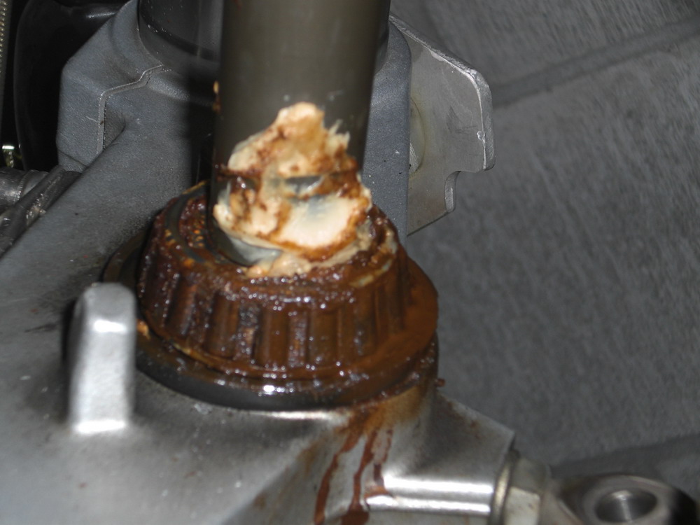

luhbo Posted February 15, 2012 Posted February 15, 2012 .. and my head bearings are new and tight... They shouldn't be tight. Loose them so that you can hear or feel a faint movement, then you're on the safe side. A loose head bearing will ruin the bearing, but not your driving. Hubert
dave Posted February 15, 2012 Author Posted February 15, 2012 An alternative is to take the weight off the front wheel, slowly tighten the steering bearing tension nut while checking for binding by moving the handlebars. When binding is encountered, back the nut off just enough to allow the bars to move freely.

luhbo Posted February 15, 2012 Posted February 15, 2012 ... An alternative is to take the weight off the front wheel, slowly tighten the steering bearing tension nut while checking for binding by moving the handlebars. When binding is encountered, back the nut off just enough to allow the bars to move freely. Binding is a bit vaguely defined with the above. Therefore, if you want to have a little chance to get it right you should first remove everything what is similar to binding, means snakes, cabel harnesses, heavy wheels and brake shoes, things like that. In theory the above mentioned is right of course, in fact I always had too tight bearings this way. One reason can be that the bearing seats are not necessarily perfectly round, or parallel to each other, can't say. These at least are the places where the 'frame doctors' start their voodoo stuff. Having the thing a little bit on the loose side for me worked perfectly so far. But as always: to each his own. Hubert

luhbo Posted February 15, 2012 Posted February 15, 2012 A sloppy head-bearing can cost you your life when it is the cause of a death-wobble.... and I feel " listening" a tad bit more "vague". ... that's why they call it death-wobble I guess But no need to argue here. When I checked lorry wheel bearings on a weekly basis once this was the proper method. Screw in the bearings until you feel the wheel going locked, then loosen 45° and fix the nut. Easy thing. Some good time ago we discussed here what adjusting method the fellows down in Mandello would use for this task. Besides avoiding any grease in this process they obviously get the rest of it working astonishing well. One had the idea they might use a spring balance attached to one fork leg and then torque the bearing down until moving the fork shows the proper force (or responding hinge moment). I mean, you normaly can't tell a badly paid line worker "just make it right", they need some objective guideline. hubert
Lucky Phil Posted February 15, 2012 Posted February 15, 2012 A sloppy head-bearing can cost you your life when it is the cause of a death-wobble.... and I feel " listening" a tad bit more "vague". ... that's why they call it death-wobble I guess But no need to argue here. When I checked lorry wheel bearings on a weekly basis once this was the proper method. Screw in the bearings until you feel the wheel going locked, then loosen 45° and fix the nut. Easy thing. Some good time ago we discussed here what adjusting method the fellows down in Mandello would use for this task. Besides avoiding any grease in this process they obviously get the rest of it working astonishing well. One had the idea they might use a spring balance attached to one fork leg and then torque the bearing down until moving the fork shows the proper force (or responding hinge moment). I mean, you normaly can't tell a badly paid line worker "just make it right", they need some objective guideline. hubert There is a definite difference between the adjustment of a tapered bearing when used on a lorry or automotive wheel application and that of a steering head bearing on a motorcycle.When adjusting for a "wheel" application then slightly loose is preferable to slightly tight.This is because of the heat generated by the spinning bearing in that application. On a motorcycle steering head heat generation due to rotation is not an issue and the focus is on zero play or slack without to much drag or tightness. So to sum up tapered bearings....for automotive wheel....er on the side of play and for motorcycle steering heads......er on the side of zero play or slightly tight.Steering head bearings should be adjusted so they "never" have any play Ciao
