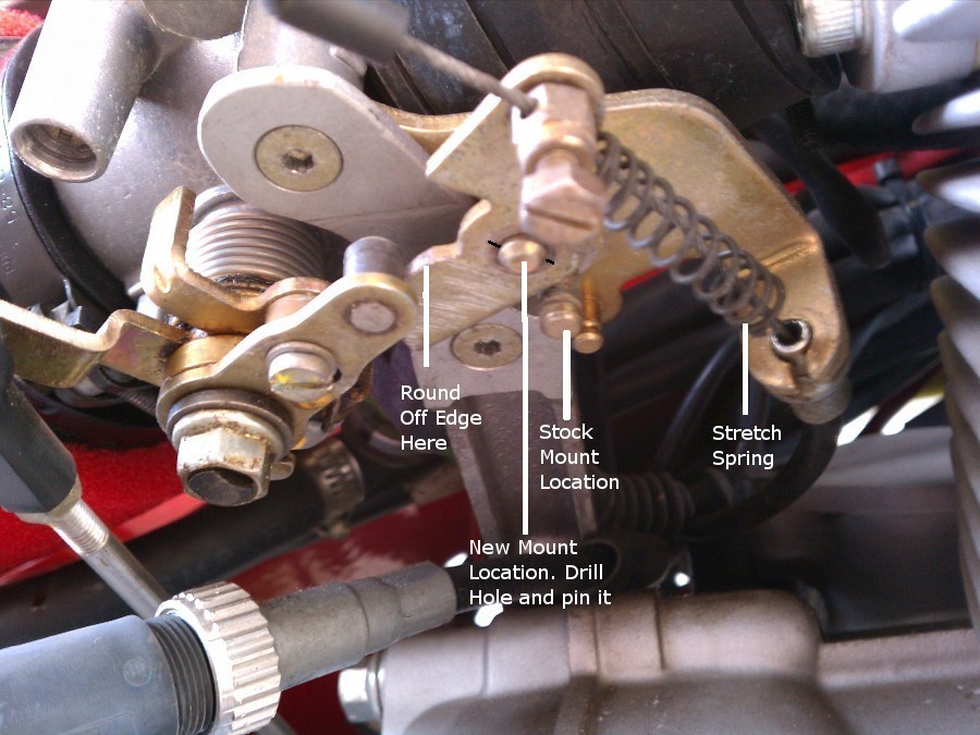

furry Posted December 3, 2011 Posted December 3, 2011 I did this trick on my old Jackal and it worked like a charm, I loggel many a mile without problems. The picture is of my V11 I just did. The Pic will explain most of it but here is a step-by-step of the deal: The fast idle cam mounted under the right TB will come off and be moved over one peg. You will see the unused peg. You will need to do a few simple things: (1) Grind down the sharp edge on the cam to make it more of a smoothe roll on the linkage. (2) Add a small spacer or washer to space the cam down to center the linkage roller. (3) Stretch the spring out to cover the extra cable gained. (4) Hardest part; drill a small hole in the peg and pin it so the cam doesn't fall off. DONE! Working the fast idle will give just under 1/2 throttle. I have found it to be more than sufficient cruising light throttle. It gives plenty throttle to pull hills and such. Make sure you stretch the spring and work it to make sure there is no hang up in operation. Enjoy!!
luhbo Posted December 4, 2011 Posted December 4, 2011 The linkage is not up to the task you overload it. The engine will run rather badly synchronised this way. I like the idea, though. Hubert
furry Posted December 5, 2011 Author Posted December 5, 2011 I couldn't see where it makes a difference operating via left tb linkage v/s right tb linkage. The cross over rod seems up to the task.. That being said this mod should be used to give the throttle hand a rest for a bit, not log hundreds of miles lol. I can assure you this mod does operate flawlessly as I have use it extensively.

Kiwi_Roy Posted April 3, 2012 Posted April 3, 2012 That's a brilliant idea, I have often wished I could give it enough throttle so I could take my right hand off to do something, the stock cam doesn't quite do it.
Mad Farquhar Posted June 24, 2012 Posted June 24, 2012 That's a brilliant idea, I have often wished I could give it enough throttle so I could take my right hand off to do something, the stock cam doesn't quite do it. I have carried out this mod and it's a breeze. Tomorrow I will test it as a cruise control. The fast idle seems to be more adjustable too.
