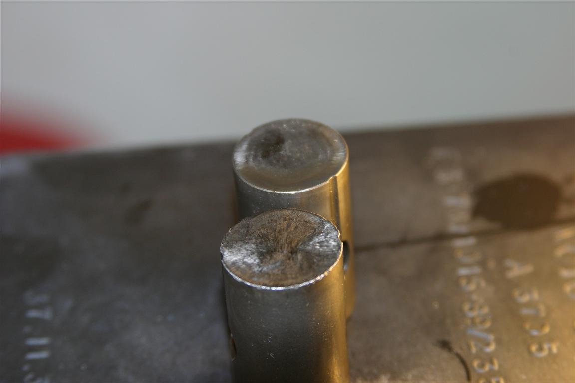

Chuck Posted December 14, 2011 Posted December 14, 2011 The tappet is case hardened. That means it is hardened only a few thousandths of an inch deep. Once worn through that layer (for whatever reason) wear accelerates geometrically. At any rate, this is calling for new cam, lifters, a look at the oil pump, cleaning the galleries, the whole enchilada. Not fun, but necessary, or you'll be doing it again...

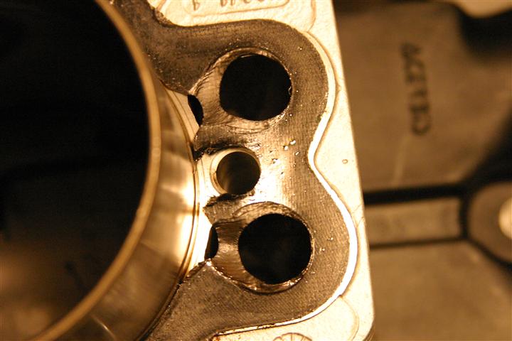

Olivier Posted December 14, 2011 Author Posted December 14, 2011 Thank you again to all of you for your comments and recommendations. Great Forum!! For information, more pictures here. Note that the gasket between the Crankcase and the cylinder was not fitting correctly
luhbo Posted December 14, 2011 Posted December 14, 2011 Your gasket is and was ok. Search other forums or engine shops in your neighbourhood for shops specialised in regrinding cams. I had mine redone after 120.000 km for about 100 USD, incl. hardening and S/H. You need a template, though. Maybe one of your US fellas has one laying around to help you out. Regrinding your tappets is no option unfortunately, as one is crap anyway. I had mine regrinded at the company I work for, just a plain cut of 0,1 mm, without rehardening, and they do well for another 15.000s km in the meantime. Hubert
Mike Stewart Posted December 15, 2011 Posted December 15, 2011 You should be able to have the 3 good lifters refinished, that is only IF they have no pitting. Also, the lifters are NOT refinished flat, they have a very slight convex to them on their face. The way to check for worn lifters is to apply a light coat of engine oil to their face and put two lifters together. While holding one up, the lifters should not stick together, if they do, they are worn and should be replaced or refinished. Mike
luhbo Posted December 15, 2011 Posted December 15, 2011 You should be able to have the 3 good lifters refinished, that is only IF they have no pitting. Also, the lifters are NOT refinished flat, they have a very slight convex to them on their face. ... Some say that is so, some say it's not. So far no one could show me a drawing or the like to proof the first or the latter. In my case, that means in my very special case because I did that on my own bike and not on the net, and important as well, for free, my colleague had to take down rather much material because of the inevitable pitting. For me that is good for 15.000 kms now. The entire experiment was well worth its costs. Anyway, if you had to pay for grinding and on top of that have a set of probably weak tappets anyway, of course you better buy a set of new ones. They shouldn't ruin the budget. Hubert

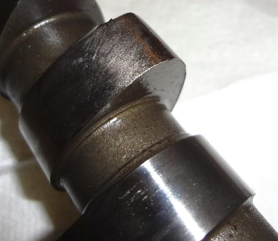

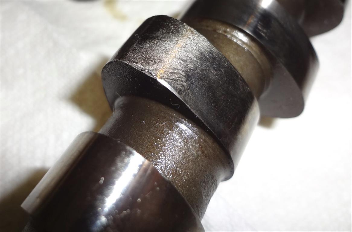

Olivier Posted February 5, 2012 Author Posted February 5, 2012 As a follow up on my tappet/camshaft failure; I've been struggling to take the timing system out, mainly because of the 32mm nut on the crankshaft. I was finally able to remove the camshaft today. The lobe corresponding to the damaged tappet doesn't look good. Next step, I'll take the camshaft to Moto International, they have proposed to look at the camshaft, if it can be rebuilt (acceptable cost), or if I need a new one :-( Pictures below attachment=11461:Camshaft_1 (Medium).jpg] Olivier
