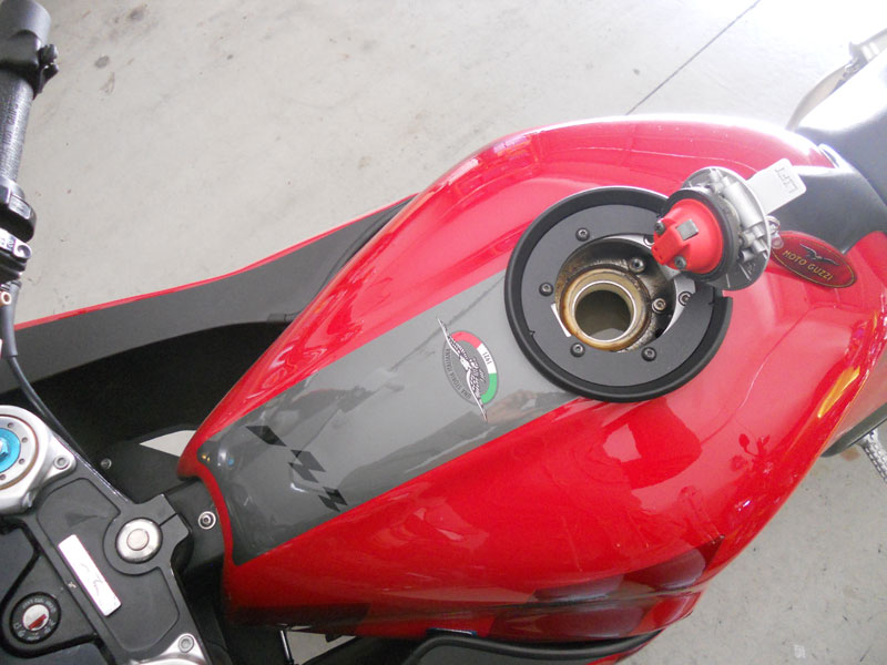

VNA Posted March 24, 2012 Posted March 24, 2012 The Givi Tanklock will work on the V11's, even if Givi doesn't think so. They sell a mounting ring for the Triumph Street Triple/Daytona (#BF02). Since my other bike is a Street Triple, I measured and compared them. Sure enough, the tank ring is the same size on both my V11 Le Mans and my Street Triple so I ordered the Givi tank bag and the mounting ring. I received everything today and the mounting ring fit perfect. I had ordered the Givi T480 Tanklock bag and it's just too big for me. Actually, the size of the tank bag itself isn't any bigger than my Triumph tank bag it's just that it sits higher due to the mounting system. I'm going to return it and try the T489 which is the slightly smaller tank bag.

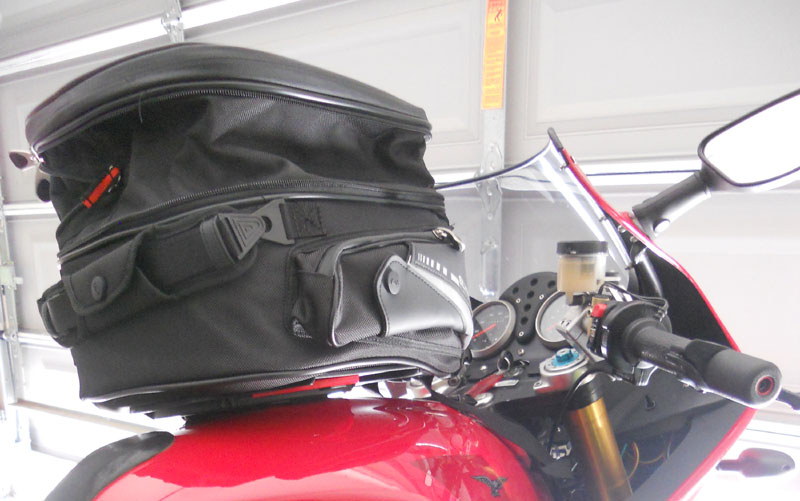

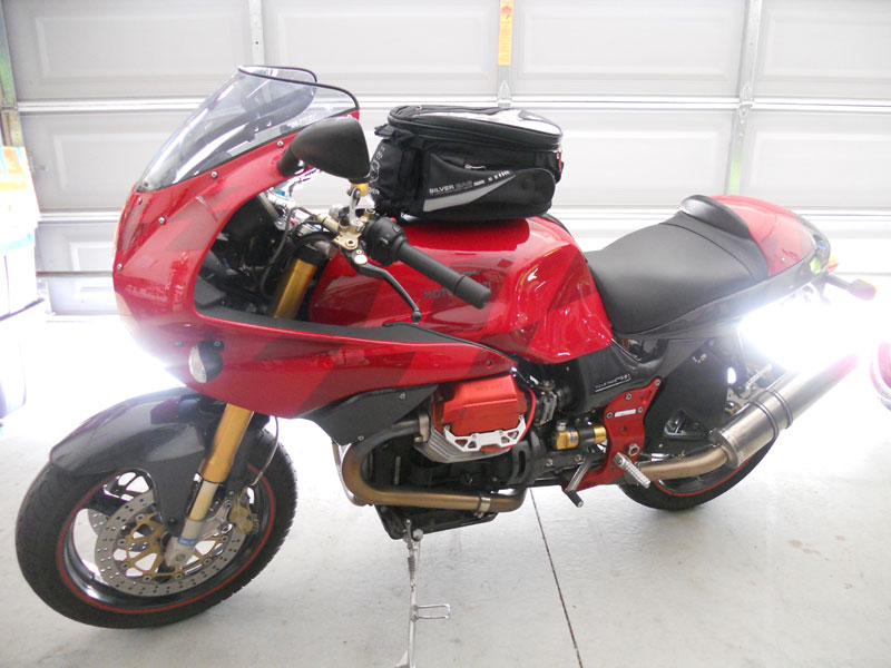

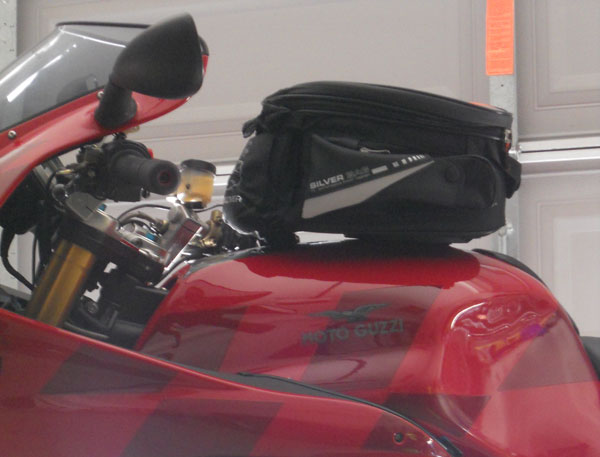

VNA Posted March 26, 2012 Posted March 26, 2012 Here are some photos of how the tank lock ring fits. 1
VNA Posted March 26, 2012 Posted March 26, 2012 Even though it's really good quality, I'm not sure if I'll stick with the Givi system. The main reason being that the height of the tank bag isn't compatible with my short arms and upper torso <_>

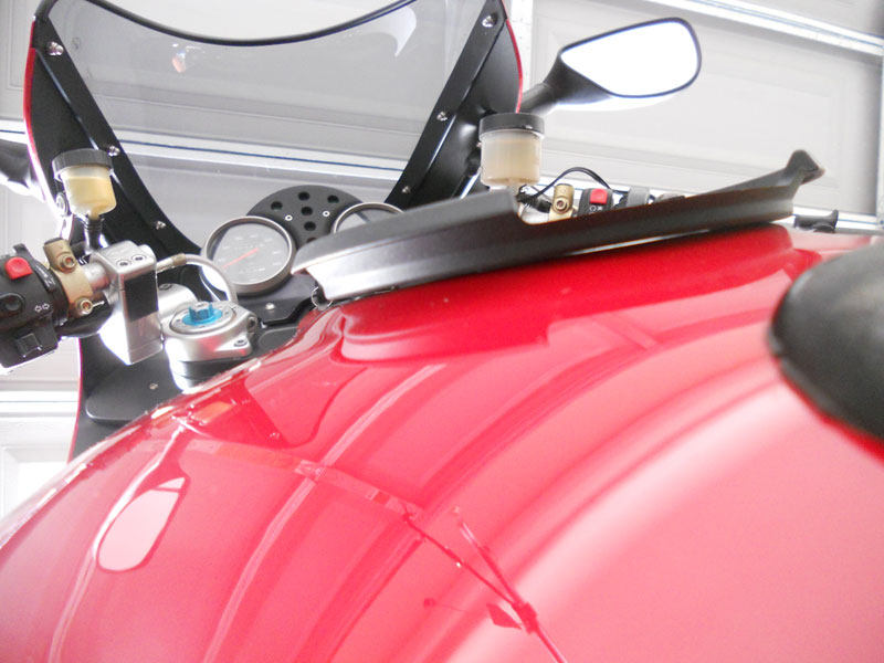

abouc Posted April 17, 2012 Posted April 17, 2012 It doesn't look like that Givi system would be compatible with older V11s that have the rubber chin pad on the tank.
Admin Jaap Posted April 17, 2012 Posted April 17, 2012 On 4/17/2012 at 8:19 AM, abouc said: It doesn't look like that Givi system would be compatible with older V11s that have the rubber chin pad on the tank. Put some washers or bushes between both rings, longer M6 bolts and you're ready. 2
Trevini Posted April 17, 2012 Posted April 17, 2012 It's a nice idea, but I'd be a bit wary of causing damage to the plastic tank if you had anything remotely weighty in the bag (even a book of maps!), moreso if it's spaced up to clear the pad.
