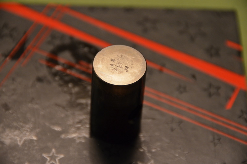

Bjor Posted February 9, 2012 Posted February 9, 2012 I'm installing my new Mike Rich pistons, and give the cylinder heads an overhaul while being at it. I noticed that the tappet of the right hand exhaust valve is slightly pitted, and consequently will be replaced. As I understand, it is quite normal that just this tappet gets it, due to a not perfect oiling system in our Italian beauties. However I don't think it has gone as far as to damage the camshaft... But the rocker of the the right hand intake valve does not look nice. Is this part hardened, so that once wear has gone through the hardened part it will accelerate? What's the reason for this wear? The bike has less than 50' km, and all the other rockers are fine... Anything to do with it, or should it be replaced with a new one?

luhbo Posted February 11, 2012 Posted February 11, 2012 Mine would make another 50.000 with these, probably. You can regrind and polish the rockerarm using an oil stone. Pitting is not a matter of oiling and not uncommon at highly stressed parts (gears, reardrive e.a.). Hubert

thumper Posted February 11, 2012 Posted February 11, 2012 That rocker looks a lot like a Ducati 996 rocker that did and does have flaking problems. They are crome plated on the wear pads. EMS will grind and replate a Ducati rocker they may do a Guzzi as well. Loose valve clearances is one of the main causes for the Ducati wear, I am wondering if all of us going to the looser world spec. on the valve adjustments this is the reason we are seeing a lot more tapet, rocker and came wear. Just a observation. What valve clearances were you running?
Gio Posted February 11, 2012 Posted February 11, 2012 Not wishing to hijack Bjor's thread, but I have made similar observations. The left side rocker arm pads were very smooth, but right side have some very small pits (detectable via fingernail) - particularly the exhaust (see attached pic - may not be obvious). Bike has just under 85,000 km and I was running 6 and 8 thou clearances (measured 7/9 before re-torque) but think I will back these down to 5/7 or even 4/6 again. So I guess I have the same question as Bjor - to try and grind / polish out the pits or will this do more damage than good ..?
thumper Posted February 11, 2012 Posted February 11, 2012 If a Ducati rocker looked like that they would be recromed or replaced. Metal to untreated metal will wear quickly. I know the valve setup is very different between the bikes But it does seem odd that now the goose has somthing in common with the duck, FLAKING ROCKERS. I have a 2000 996 and had to have 4 rockers recromed.If others have just cleaned them up and reused please chime in and let us know how long they have gone and do the valves need more frequent adjustments.
luhbo Posted February 12, 2012 Posted February 12, 2012 ...But why grind the rocker arm? Is it to prevent it from damaging the stem of the valve, or is it to get a more even surface and thus a more accurate valve clearance? ... I noticed that over the time the valve train became remarkably louder and I thought this particular point could be part of the emissions. It was not. Anyway a smooth surface there could take off some stress from the valves' endings, as you wrote already, otherwise the valve guides will go even quicker (bigger lateral forces). If you still have the heads off you could consider the Guzziology idea of arming (and enlarging) the valve ends by putting Ducati shims over them. Hubert

luhbo Posted February 12, 2012 Posted February 12, 2012 ... 1) grind/polish to remove the pits (not sure how much material can safely be removed - Hubert?) ... No idea, sorry. I thought it could hardly become worse as it was already, and as the 2.option with the $$$s was not an option I just did it. So far (25.000km) all is fine. I will make a picture next time I look after it. Actually I'll loose a finger or two should I touch anything 'frosted' outside ... 3) re-install and keep an eye on clearance for any further wear ... very tempted to go this way! ... Definitely. There is not very much movement between the mating surfaces, so nothing bad should just fall out of the blue. Just watch it, now as you're sensitised for it. Next time you pull the bearing pin you might want to mark its orientation and compare that with how the pin itself is wearing. My experience says that these rockers always look like that after 'some' time. I had 4 or 5 engines over the years, all with 100.000 at least (never bought a new one so far), so I don't think it's really a matter of batch. Hubert PS: this mug has done 125.000km. Would be nice if I had a picture of it at 50.000
luhbo Posted February 12, 2012 Posted February 12, 2012 ... Do you buy your stuff from Stein Dinse, since you are located in Germany, or do you have any better suggestions...? No, normally not. Their China stuff usually is crap, and OEM parts you can get for the same money at HMB for instance (Guzzi only). Anyway, there's not much what could go wrong with these Duc shims, so why not there. Keep us posted, so far I only could read about it. Consider also the possible need to shorten the valves a bit to keep the kinematics at least in range (tools at hand?). Don't know how thick these shims are. Hubert
