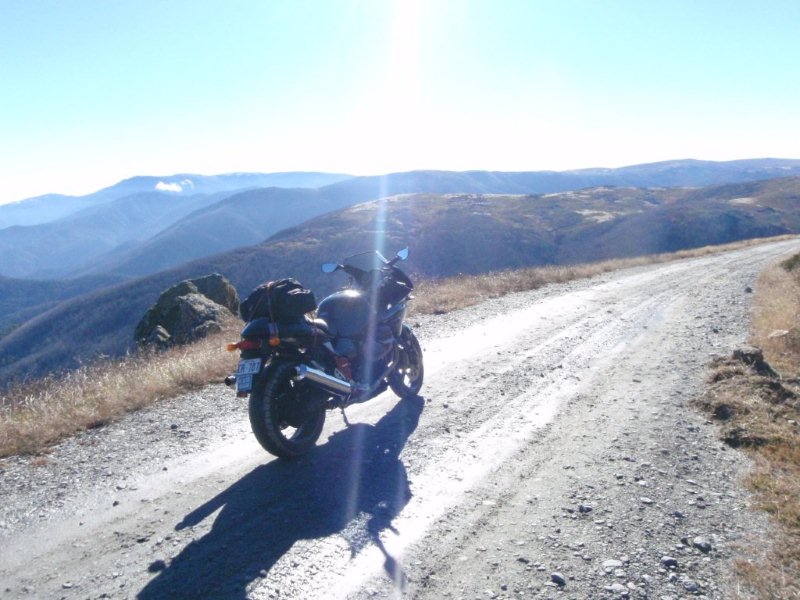

PDoz Posted May 20, 2012 Posted May 20, 2012 G'day, I'm wondering if anyone has fitted a wilburs 640 rear shock into a v11 and if so, have you been wishing ever since that you spent the extra $ on a 641 with dual compression dampening adjustment? I suspect I'll be spending the extra $ on a 641, but I'd love to hear that the 640 is so good I can spend the extra $ on the forks instead. I've just spent 2 wonderfull days exploring the limitations of the standard suspension on my 03 lemans. Lots of fantastic memories of twisty roads with stunning scenery, but a few moments I'd rather forget where I'd have been better off on the KTM 990 I was chasing. Australian "roads".... what more can I say. Perhaps a picture might help?
PDoz Posted May 20, 2012 Author Posted May 20, 2012 Sorry, I can't work out how to continue directly underneath the picture. If it's any help, I'm re -learning road riding after 20 years of almost exclusively dirt riding, I've had the guzzi for 5 months so far and have well and truly reached the limits of the suspension both ends. I'm not a particularly fast rider - out of our group of 50 this weekend I was about 10th most of the time. I'm looking for safe suspension, not race suspension.
galaxiid Posted May 20, 2012 Posted May 20, 2012 On 5/20/2012 at 11:14 AM, PDoz said: Sorry, I can't work out how to continue directly underneath the picture. If it's any help, I'm re -learning road riding after 20 years of almost exclusively dirt riding, I've had the guzzi for 5 months so far and have well and truly reached the limits of the suspension both ends. I'm not a particularly fast rider - out of our group of 50 this weekend I was about 10th most of the time. I'm looking for safe suspension, not race suspension. There'll be people here much better qualified to answer your q's about suspension for the V11. Ohlins came out on some variants of the V11 and that might be worth investigating for the rear end anyway. Source one off a wrecked bike if you're lucky. A good front end ohlins would be much harder to source off a wrecked bike though. Maybe the sort of riding you are doing (looking at the road pictured) means you'd be better off on a Stelvio or an older, cheaper NTX. KTM 990???? Just what I was thinking of as the right ride too! I wish! SMT 990 PERFECTO! (Sssh)
PDoz Posted May 21, 2012 Author Posted May 21, 2012 Thanks, but I'm in love with the V11 so it stays- besides, I've got a KTM 640 I usually use for that sort of riding. This particular ride was still 90 % tight but bumpy bitumin and I felt like giving the guzzi a run. Even on the bitumin the back was playing up on some of the harder hits, and if there were more than 2 in a row on corners things were getting interesting. The rest of the time the bike was flawless, so I'm hoping a new rear will improve things. Then again, if you know of a nice NTX 650 for sale in australia...... I have a soft spot for small bore guzzis.
