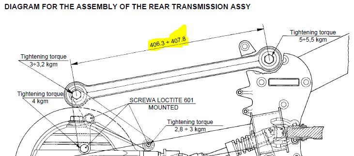

Admin Jaap Posted September 29, 2012 Share Posted September 29, 2012 While where at it, what's the measurement between both holes? The one in the picture below is from a 1100 sport. Is it the same on a V11? Link to comment Share on other sites More sharing options...
