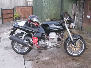

Gritman Posted November 19, 2012 Author Posted November 19, 2012 and winter has arrived again! Time to take to the shed and execute the plan. Strip down a perfectly serviceable V11 Sport and remove the engine. Place new engine conveniently for swap. Remove the 6-speed 'box from the old pushrod lump and bolt it to the back of the V10 motor. Does it look like it will fit? Fantastic. Some reworking of the reg/rect location on the fromt A frame - the old mount points foul the cambelt cover. Apart from that it all looks good on the first dry assembly. So, just attach a few ancillaries to check there are no issues, then strip off all the bits for coatings/platings and order the My15m. Meanwhile, the engine, throttle bodies, alternator and a clutch are up for sale to fund the next stages. See the Classifieds section of the forum if toy are interested. also lots of Centauro parts available!

docc Posted November 21, 2012 Posted November 21, 2012 Neat project! What a great motor and thanks to Umberto Todero. Gritman, What is that black frame with the red sideplates? From the Centauro?
Gritman Posted November 22, 2012 Author Posted November 22, 2012 Neat project! What a great motor and thanks to Umberto Todero. Gritman, What is that black frame with the red sideplates? From the Centauro? Thanks Docc, that is the V11 frame and plates in the photos. The Centauro lurks in another corner of the workshop, awaiting its fate As the V11/V10 hybrid will be the road bike, it will probably end up as a track day special..... Hell, there's plenty of winters to fill up with projects!
