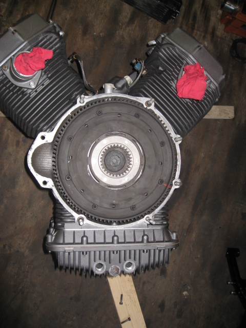

Happy new year folks! :bier: The delay on the RAM clutch has held me up a bit, but lots to do before it goes in. Decoated the motor and resprayed along with the g'box and bevel drive. Curing with a heat gun and avoiding temperature sensitive seals etc was laborious, but hopefully worth it.... you judge. I'll curse if it all falls off :bbblll:
oops :homer: crap mobile phone pic.....

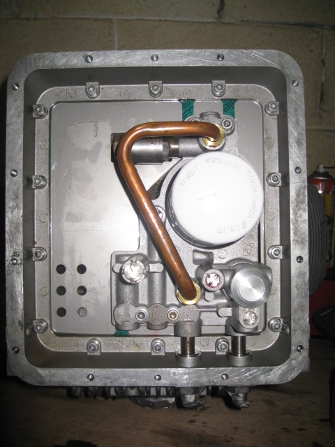

A well-timed xmas delivery from Mr Roper spared the family from too much exposure to scrooge and in went the sloppage plate. Nearly got lost inside that cavernous crankcase. So many places for the oil to hide, but not any more. :thumbsup:
you can just about make out the motor builder and date scratched onto the filter......

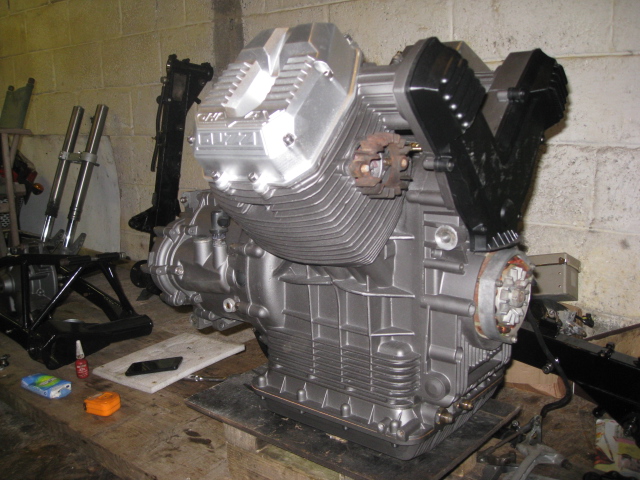

Well, heres the thing. The shed is full of 2 disassembled guzzis and I'm moving 250 miles away on Friday. :o Bitter experience tells me that a bike moved in boxes rarely gets back together :oldgit: ; a fate I am keen to avoid. Meanwhile, for the past month - well, two since the order was placed, but I'm being charitable -  I've been waiting on a RAM clutch. However, despite the assistance of mznyc & Pete Roper with the missing centre, my nerve has cracked. A 2-plater from the spare Centauro motor went in with a new pushrod cup for the 6-speeder and a new set of friction plates. This way, at least I can get the thing looking like a bike before I lose the shed at the end of march. Then with all the significant work done, it shouldn't be too hard to finish it off, despite the house build...... We shall see.
A RAM would have been sooooooo much easier to fit. How I hate aligning that stack of plates. :blush: Next week I'll mount the frame, fit the forks and swingarm and start to unravel the harness....... :luigi:
drop in the basket,
Add the plates,
then on with the 'box!
don't it look pretty? Hope that coating stays on.........
Well thats a days work for me. The nicely powder-coated frame in the background goes on next week, along with forks and swingarm - providing nothing like packing up the house gets in the way :ninja:
