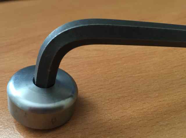

Onibaka Posted October 24, 2015 Author Posted October 24, 2015 Hello Again . I have a small question . How to remove this cover ? Lever than anything?
Scud Posted October 24, 2015 Posted October 24, 2015 The small center "nipple" is a plastic cap. Pop it out with a small flat-blade screw-driver. Under the cap, you'll see that you can use an allen-wrench to unscrew the metal part.
Onibaka Posted October 24, 2015 Author Posted October 24, 2015 Thank you,I got it,but I have this small center "nipple" metallic.Do I remove it the same way,please?
Scud Posted October 24, 2015 Posted October 24, 2015 Here is a picture with the part off the bike, and showing how the tool fits to remove it. Once you pry off the center cap, you'll see what to do. I was puzzled for long time too - I kept trying to pry off the big part - but you only need to pop out the small centerpiece. The part in the picture has threads on the other side.
