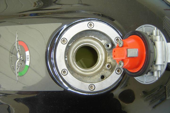

dangerous Posted January 3, 2013 Posted January 3, 2013 Hey so, when I wash the bike I get a build up of water under the cap to the point it will enter with the petrol, when on the side stand there is a hole on the lower side but it seems blocked, the smaller hole at the back of the filler breaths ok and is attached to the pipe under the tank. There are two nipples under the tak=nk as I said the right side breaths but the left does not and has never had a pipe on it... I have to assume one must be a over fill drain and proberly the larger under the cap... is it blocked?
GuzziMoto Posted January 4, 2013 Posted January 4, 2013 The one larger one lower in the your picture should be the drain that should be drain water from around the cap. It sounds like it is clogged. The other vent as I recall vent the inside of the tank through the cap. When the cap is closed it has a port that lines up with the the other hole and it vents through the middle of the cap around and down to that port, the upper of the ports in your picture. I would first try blowing compressed air through them and if that does not work a thin piece of wire to poke it out. Cover the hole into the tank to prevent debris from failing in during this (Thanks captain obvious!).

dangerous Posted January 5, 2013 Author Posted January 5, 2013 On 1/4/2013 at 2:29 AM, GuzziMoto said: The one larger one lower in the your picture should be the drain that should be drain water from around the cap. It sounds like it is clogged. The other vent as I recall vent the inside of the tank through the cap. When the cap is closed it has a port that lines up with the the other hole and it vents through the middle of the cap around and down to that port, the upper of the ports in your picture.I would first try blowing compressed air through them and if that does not work a thin piece of wire to poke it out. Cover the hole into the tank to prevent debris from failing in during this (Thanks captain obvious!). Yes right you are with the cap vent port, so my drain is blocked but I need to know where the other end of it is so as I can back flush it? as above there is two exit ports as you might call them center under the tank, the right one having a hose on it which I think is the breather... can I assume the other is my drain? and is there the chance the pipe is on the wrong nippily port thing?
dangerous Posted January 7, 2013 Author Posted January 7, 2013 you all forget bout me? Ok finely got 30mins to myself so peeled the tank off again, and to answer my own question cos none of you lot did... the right nipple under the tank is the vent and the left is the drain... I have allways had the hose on the vent which I think is wrong it should be on the drain nipple... however I found the drain nipple to be blocked with all kinds a light gunk, screwed it out and ran a drill bit with my fingers through it, Ill check it drains next wet ride or next bath.
GuzziMoto Posted January 7, 2013 Posted January 7, 2013 Sorry, I thought I had said which was which. Normally you are supposed to have a hose on each. If you are only going to have a hose on one I think I would have a hose on the tank vent as it is more likely to have gas coming out of it. But gas can come out of either and if gas spills onto a hot engine there is always a chance of bad things. So you decide. Hose is cheap. You could even T the two together and then run the hose down to safety. You can use compressed air, either from a compressor or even air from a can like we use with PC's, to blow through the drain and confirm that it is not blocked.
docc Posted January 8, 2013 Posted January 8, 2013 I "Y" mine together close to the tank. They are alittle fiddly to get on, but either one could spew fuel. The drain certainly catches any overflow from a fill-up.
dangerous Posted January 8, 2013 Author Posted January 8, 2013 On 1/7/2013 at 5:36 PM, GuzziMoto said: Sorry, I thought I had said which was which.Normally you are supposed to have a hose on each. If you are only going to have a hose on one I think I would have a hose on the tank vent as it is more likely to have gas coming out of it. But gas can come out of either and if gas spills onto a hot engine there is always a chance of bad things. So you decide. Hose is cheap. You could even T the two together and then run the hose down to safety. You can use compressed air, either from a compressor or even air from a can like we use with PC's, to blow through the drain and confirm that it is not blocked. yeah at the top it was the exit I was unsure off. I;m guessing the pissed Iti that asembled my bike forgot about one line... I would have thought fuel out of the breather is rear, I mean its for air to get in so petrol can get out... but ya right best to have both piped down.

GuzziMoto Posted January 8, 2013 Posted January 8, 2013 Y, T, either one. T fittings are cheap and common. Y fittings are probably as well. Either way will result in the same outcome. It doesn't matter. Once the cap is closed the drain one lower in your pic is closed off from the tank and does nothing as far as fuel goes. The gasket around the tank opening would have to fail to allow fuel there AFTER the cap is closed. Mostly that is for water when it rains and fuel spillage when filling up.
