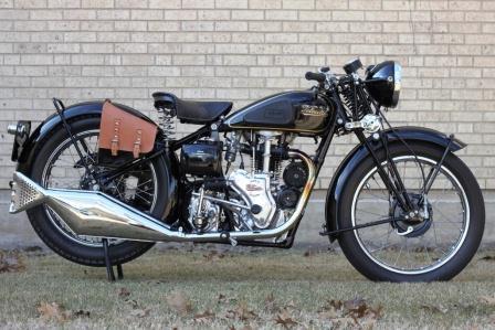

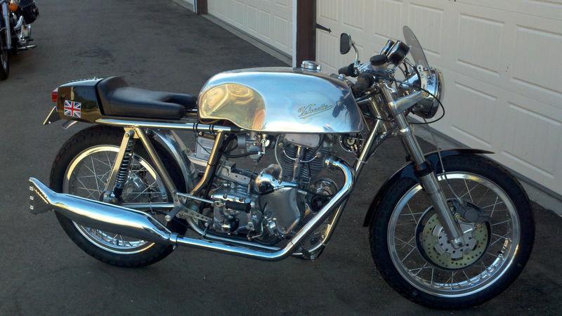

Kiwi_Roy Posted January 30, 2013 Posted January 30, 2013 First off, nice pair of classics you have listed there. A friend here in BC has a couple of old Velos as well, also a Guzzi owner. I have K&Ns on my V11, when I first put them on I noticed a flat spot at mid range so I reasoned that the throttle body intake rubbers were acting as a velocity stack. When I extended the filter with the intake rubber, sure enough the flat spot dissappeared. This would also get them back behind the side covers. I chose to leave my covers off exposing the nice rear shock. There's a large cable loom wrapped around the seat release key, that can be re-located under the tank where the airbox was. Then you just have to figure out what to do with the breather and air temperature sensor from the airbox. I don't recall it effected the fueling but I have an after market MyECU Sorry I don't recall the part No but I remember thinking ones with a slight angle might have fitted better. Roy

SCole Posted January 30, 2013 Author Posted January 30, 2013 Thanks everyone. I am going to do the power commander route later in the year and I do have a local guy with a dyno to get the map right on it. Need tires(the originals are on it) and a few other things ahead of that though. For Roy here are some pics of my Velo's and they don't run K&N's, they run nothing! So, I wanted a bike with an electric start for quick go's but didn't want something you see all the time....how I ended up here. Riden the bike a little and it fits the bill well and I am an air cooled kind of guy, by age unfortunately

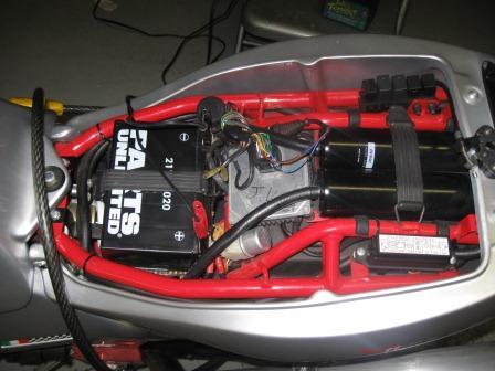

SCole Posted February 1, 2013 Author Posted February 1, 2013 Okay guys, got a couple more. Which way is the ECU suppose to install....fins up or fins down? Mine came fins down but I have seen them both ways and read that the plug up can get the plug shorted out by the seat compressing against it? And the fork tubes are hitting the tank on both sides. So is this a stretched tank? I gotta quit looking so much........ Thanks
emry Posted February 1, 2013 Posted February 1, 2013 Fins up. Yes to the expanded tank. I had to relocate the rear mount on mine because of it.
SCole Posted February 1, 2013 Author Posted February 1, 2013 Emry, Can I get some pics and instruction on how you moved your tank back? Thanks
mznyc Posted February 1, 2013 Posted February 1, 2013 Be careful removing/installing ECU, because the battery leads will short if you touch them.ALWAYS have the Neg of the battery disconnected when working on the ECU.I disconnect both leads before touching it.
