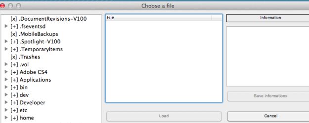

Jazzamoto Posted April 16, 2017 Posted April 16, 2017 This is directed to Mac Book Pro users who are running Guzzidiag. I've been trying to load a new map to the 15M ECU on my 2004 V11 Cafe Sport. When I open the IAW 15 Writer app and hit the "click to choose file" button it brings up a box called "Choose a file" (shown in the screen shot below). Not a box I've seen before. All the items listed in the left box are dead links BTW. How do I get the writer to search my downloads, desktop, etc? Thanks! John (it was all so simple way back when I had my 386sx!) 1
swooshdave Posted April 17, 2017 Posted April 17, 2017 Because it's probably a Java app it's showing a bunch of normally hidden Unix files. I'm going to download the software now and try it out. Stay tuned. Sent from my iPhone using Tapatalk
